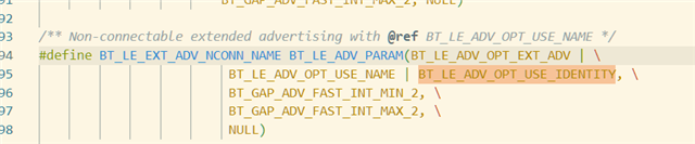

HI guys I am working on nrf connect sdk v2.0.0, I am trying to modify periodic_adv example to stop changing mac address every time an advertising restart.

	err = bt_le_ext_adv_create(BT_LE_EXT_ADV_NCONN_NAME, NULL, &adv); //  BT_LE_EXT_ADV_NCONN_NAME  BT_LE_EXT_ADV_SCAN_NAME
