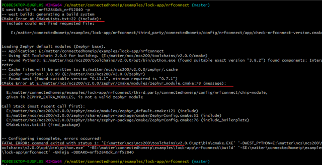

but I can't build the project https://github.com/project-chip/connectedhomeip/tree/master/examples/lock-app/nrfconnect
I wonder if I can build in windows platform.

Hi,Marte,
1: I have successfully build the matter project :door lock (NCS) ;
2: I still want my development to be based on the link https://github.com/project-chip/connectedhomeip/tree/master/examples/lock-app/nrfconnect
$ source E:/matter/ncs/ncs200/v2.0.0/zephyr/zephyr-env.sh
$ export ZEPHYR_TOOLCHAIN_VARIANT=gnuarmemb
$ export GNUARMEMB_TOOLCHAIN_PATH=E:/matter/ncs/ncs200/toolchains/v2.0.0/
i'm not sure I can do it on windows.
bugplus
Based on your error message the CHIP_ROOT variable is set to an incorrect value. This is because the method that is used to set it is not supported in Windows. You can fix this error by changing the following in CMakeLists.txt:
get_filename_component(CHIP_ROOT ${CMAKE_CURRENT_SOURCE_DIR}/third_party/connectedhomeip REALPATH)
to this:
get_filename_component(CHIP_ROOT ${CMAKE_CURRENT_SOURCE_DIR}/../../.. REALPATH)
