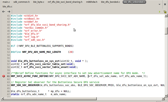

    thanks to mronos answer I got the bootloader compiled (I'd really like to know why nordic doesn't provide examples that compile instead of having to spend hours working through tutorials and make lots of changes to files, settings, linker allocations etc.), ran it and downloaded software onto the device via ble. Great !
    Now I am trying to start the dfu from my application software so that I can finally dump all that nordic stuff on my customers desk and say good-bye to it for good.
    But I am getting a compile error in "ble_dfu_unbonded.c" that I cannot figure out: "unknown type name 'nrf_dfu_set_adv_name_svci_async_t'". One post here I found that suggested to define "NRF_DFU_SVCI_ENABLED" (love this nordic software, very intuitive and easy to figure out by yourself) but that did not work either.
    Anybody an idea what is going wrong?
    Kind Regards
    p.s.: is there actually an easy way to simply jump back to the boot loader? I have my own service that could trigger that.
  • But I am getting a compile error in "ble_dfu_unbonded.c" that I cannot figure out: "unknown type name 'nrf_dfu_set_adv_name_svci_async_t'". One post here I found that suggested to define "NRF_DFU_SVCI_ENABLED"
    In addition to that I think you need NRF_DFU_TRANSPORT_BLE=1
    I agree about the ease of figuring out... I think I got these from the buttonless dfu example a long time ago, but taking a module from one example to another is not easy with this sdk.
    Yes, the bootloader entry method GPREGRET does that. You write a magic value to a certain register which the bootloader reads.
  • Hello mrono,
    NRF_DFU_TRANSPORT_BLE=1 did the trick and I owe you big time for saving me tons of time and not having my blood pressure going sky high when digging through nordic "code". If you are ever in the south of Ireland I'll buy you a pint (or more). So I got it compiled.
    After sheer endless permutations of the nordic attribute table size (hard coded numbers, not sure when I saw something like this the last time) and the inherent permutations of sd ram allocation I finally got it even to start up.
    I can see the dfu service in my application but when I start it from the nrf connect desktop I get the following microsoft style error message on the debug message output:
