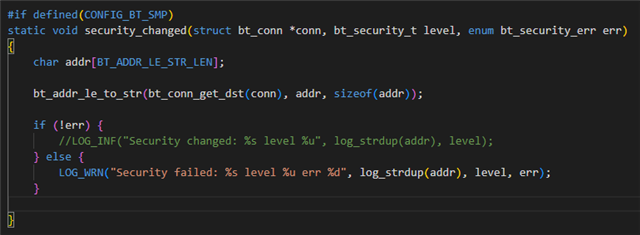

I use bt_unpair to delete the bonding data once the error comes out, but this will lead to a disconnection first, which is not what I expect.
Are you calling it while you're already in a connection? Are you deleting the bonding information after the secure connection has already been established?
jhc said:I use bt_unpair to delete the bonding data once the error comes out, but this will lead to a disconnection first, which is not what I expect.
What did you expect instead?

I want it could be repaired during the connection without reconnecting again by after deleted bonding data.
If you're deleting the bond while in a connection, then I think it's expected that it will disconnect.
I'm wondering why you're deleting the bond while in a connection? What is the purpose of this?

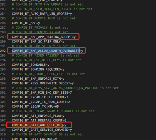

Back to the question of this thread, how to let the pairing continue smoothly (without any reconnection) when I get a BT_SECURITY_ERR_PIN_OR_KEY_MISSING error during the pairing phase.
That is what I expected originally.
Sure, these three CONFIGs are all already enabled, but cann't work.
