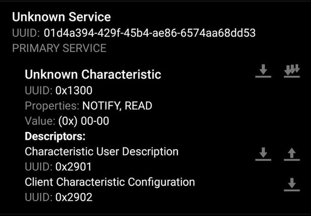

    Attach is my current setup with 16bit value.
    If I decided to send it every 20ms then 20*2 = 40bytes. I prefer custom characteristic but is this still doable with this setup since its too big or is array permissible with characteristic?  Or do I need to switch to NUS?
    Using a custom service is totally fine, but you may need to modify it a bit if you want to follow my above suggestion to send larger number of samples in each transfer. The characteristics can support variable length. NUS is also a custom service, defined by Nordic to send variable length strings over BLE.

    And based on what I have read I have to change the MTU size since the default is 23bytes?
    If you want to send notification with larger size than the current MTU size, you need to increase it yes. There are also other parameters that can help you increase the throughput (DLE, connection event length extension, 2M PHY, etc), see Bluetooth Low Energy data throughput.
