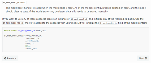

I have implemented a set of custom mesh models on nCS. In vendor models we have reset handlers, as in nrf documentation: https://developer.nordicsemi.com/nRF_Connect_SDK/doc/2.0.0/nrf/ug_bt_mesh_vendor_model_dev_overview.html#:~:text=The%20model%20reset%20handler%20is%20called%20when%20the%20mesh%20node%20is%20reset
I have two questions here:
  1. What are the guidelines to write reset handlers, I mean what should they do..?

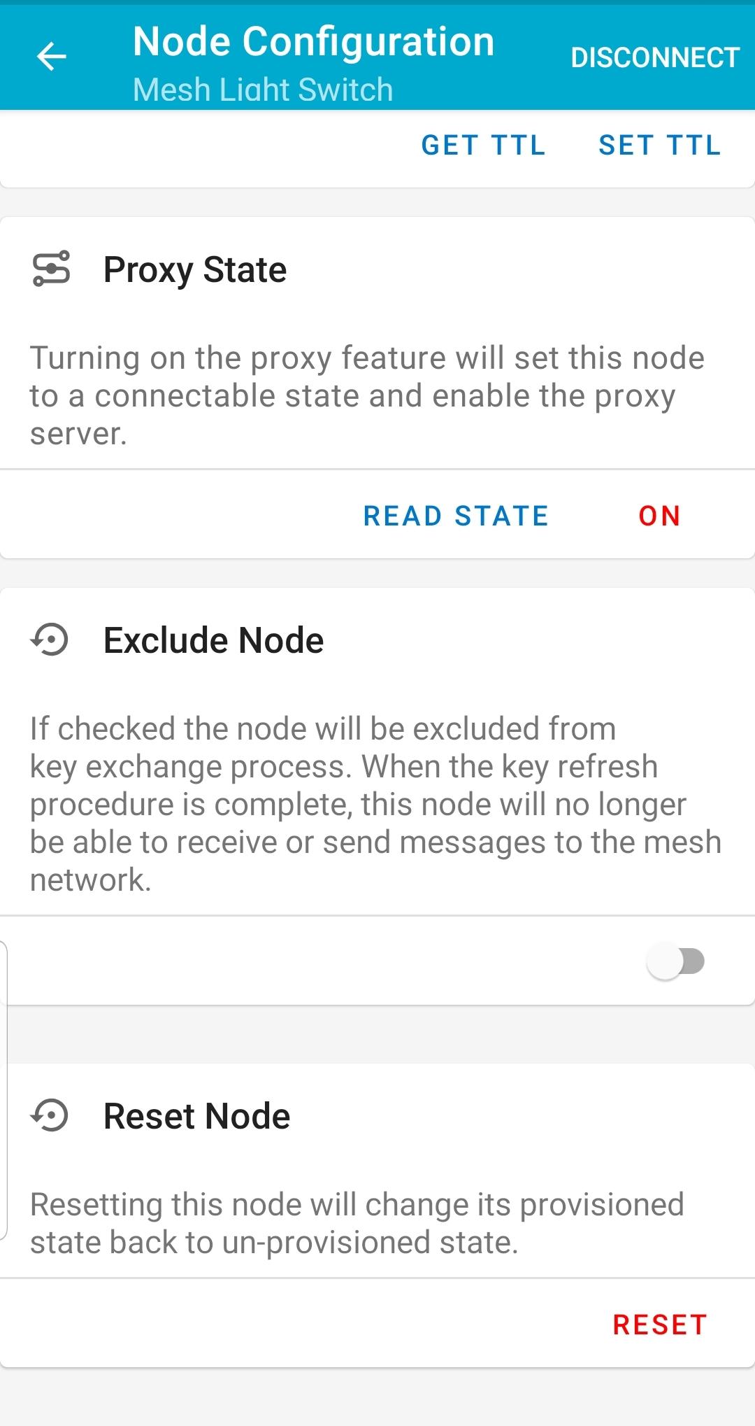

  2. How do I trigger reset handlers to test..? I do not know how a node is reset, hence kindly suggest how to trigger reset handler.
