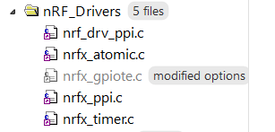

"undefined reference to 'nrfx_gpiote...'" when using "nrf_drv_gpiote_..."
Here's what i am struggling with: my code generates a error while building for every line where i use a function starting with "nrf_drv_gpio_..." saying there is an undefined reference to "nrfx_gpiote_..." which i have never used, especially not in this code.  I am using a modified example from the nRF5 SDK for my nRF52840dk. I dont understand why my code is giving an undefined reference to something i'm not using. Any help would be appreciated so i can learn what it takes to make this work. I am still trying to learn nRF5 in SES so i don't have much experience with debugging issues like this.
Here's my GPIOTE code modified from the file from the nRF5 SKD
