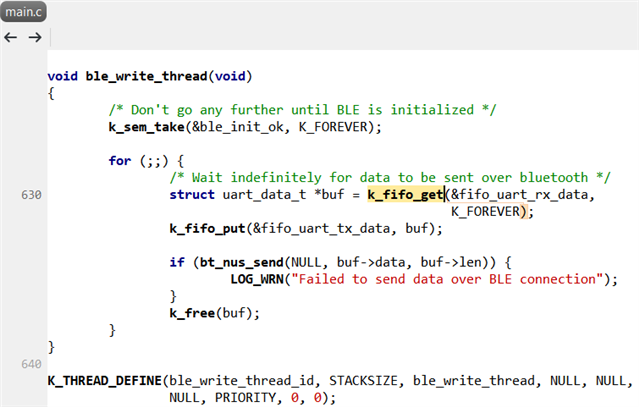

I use the modified version of the USBD example(nRF5_SDK_17.1.0_ddde560\examples\peripheral\usbd) in nRF5 SDK from here. (My development kit is nRF52840DK.)
And I would like to add some funtions like the peripheral_uart sample(ncs\v1.7.0\nrf\samples\bluetooth\peripheral_uart) in NCS shown in the picture below.
I have to write the data from the keyboard to the development kit through the endpoint, so I need a similar function to use in nRF5 SDK like k_fifo_get and ble_write_thread that could let the development kit monitor whether there is data from the computer at any time.
Is there any funtion I could use in nRF5 SDK? Or is there any example I could refer to?

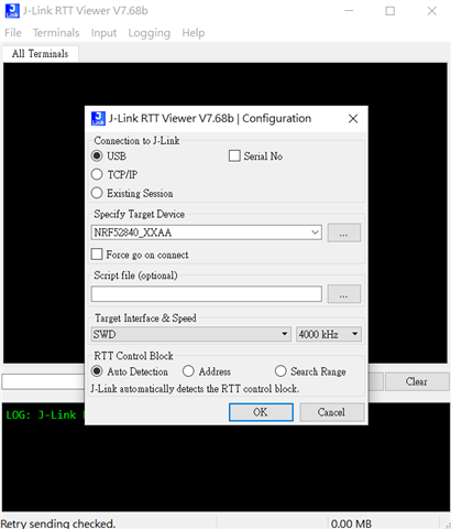

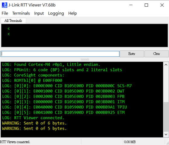

    Then I test it on RTT Viewer to confirm whether the board receive the data that I send.
    I select the "USB" option, and then click "OK" as the picture below.
    However, it only shows the warning messages but not the success messages.
    It seems like the board didn't get any data from the PC.
    How could I solve this problem? Or...Should I use another function?

    Another problem I have is that the RTT Viewer seems to only be able to transfer data through the JLINK CDC UART Port and cannot transfer data through the nRF5 USB port.
    Is my understanding correct?
    If I understand it correctly, is there any other tool that can transfer data through the nRF5 USB port?
    If I understand it wrong, how should I use it correctly?
    RTT works by storing data in RAM, and the Segger debugger reading it out. It is not possible to use RTT via the USB port.
    If you want to do logging via USB you need something else, for instance CDC-ACM, as demonstrated by the USB CDC ACM Example.
