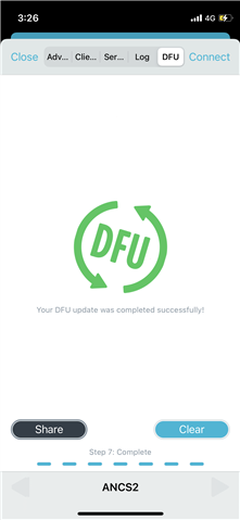

Received an error: 0x00000003 after programming softdevice, bootloader, and application hex files
I am testing secure DFU with hex files under D:\nRF5_SDK_16\examples\dfu\secure_dfu_test_images\ble\nrf52832 folder. After programming softdevice, bootloader, and application hex files through J-Link Commander script, Received an error: 0x00000003 occurred.

    Are you flashing the bootloader with bonds? You'll get an error if you program bootloader with bonds without a valid application + settings page.
    Can you try to program the:
    1.  Application: ble_app_buttonless_dfu_without_bonds_s132_with_setting_page.hex
    2.  Softdevice: softdevice_s132.hex
    3. Bootloader: bootloader_secure_ble_debug_without_bonds_s132.hex
    $ nrfjprog --program ble_app_buttonless_dfu_without_bonds_s132_with_setting_page.hex --chiperase
    $ nrfjprog --program softdevice_s132.hex
    $ nrfjprog --program bootloader_secure_ble_debug_without_bonds_s132.hex
    regards
    Jared
  • After I program secure bootloader, no error code 0x03.
