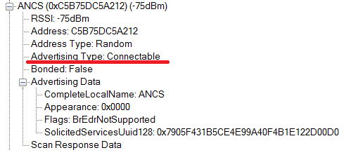

    Using Master Control Panel (MCP) for windows, check if the advertising is "Connectable". image description If it is not connectable, this must be changed in the application code.
    If it is connectable, and MCP for android still cannot connect:
    1. Go to Settings in MCP for Android
    2. Connectivity
    3. Connect to ->All Devices
    If you are still having problems, please tell me specifically which example project you are using. (The path in the SDK folder)
