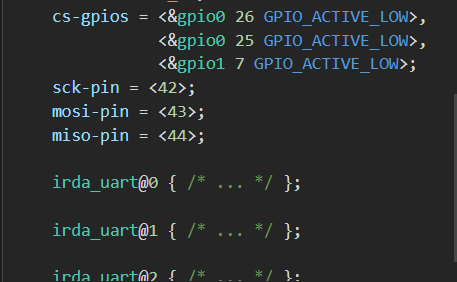

  • One thing I noticed - when I hover over the &spi1 in my overlay file to expand its contents, I see that it has added the cs-gpios information and pin assignments from the overlay. But the irda_uart nodes are showing that content automatically commented out. It seems that everything I define in there is being discarded, yet I'm not getting errors or warnings. See below.
