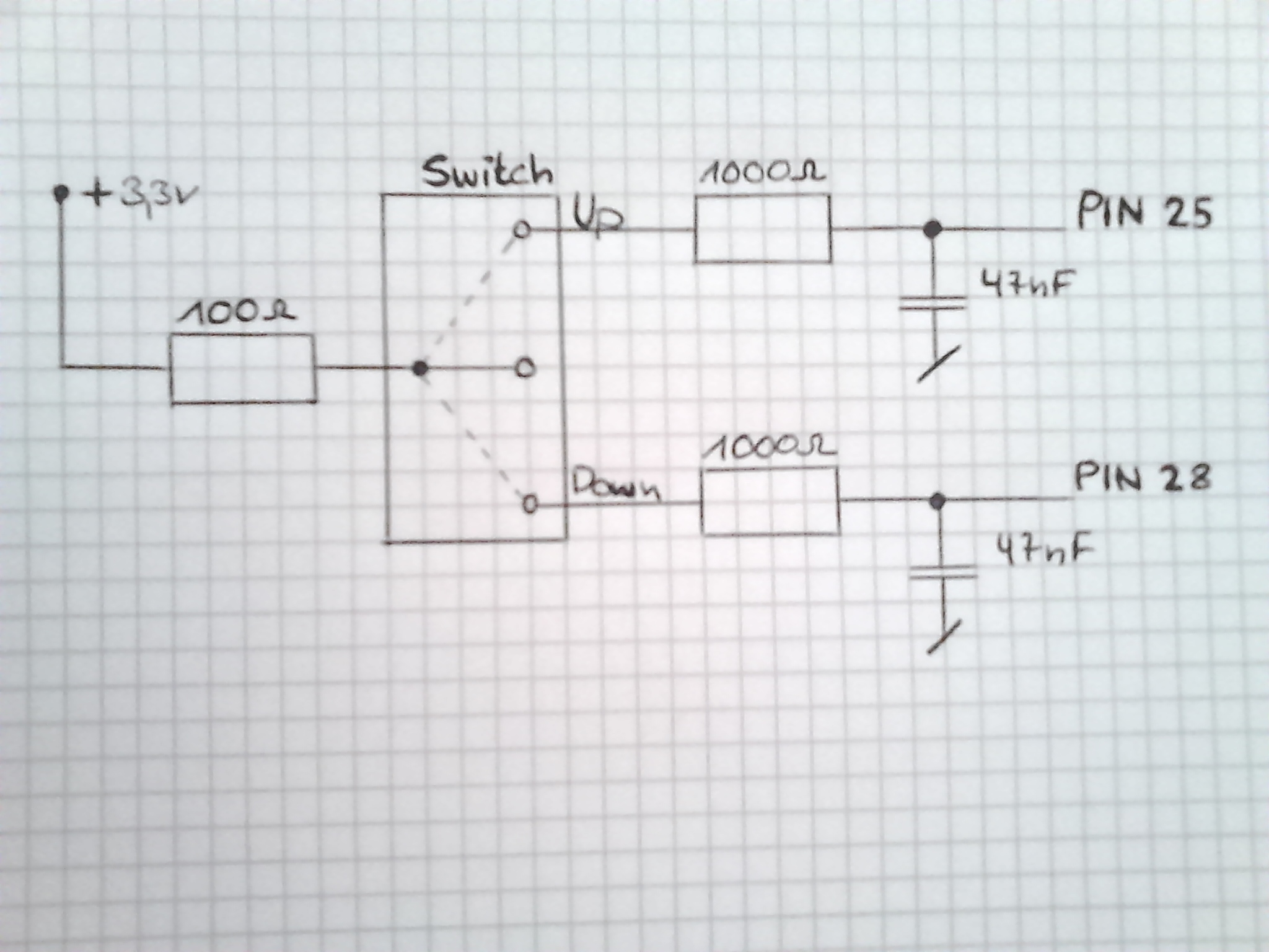

I have a switch connected on the nRF51DK Board. The switch is connected on PIN25 and PIN 28. I try to read the state of the switch.
My setup:
-nRF51DK
-SDK8.1
-SoftDevice 8.0
I defined PIN 25 and 28 as Inputs(PULLDOWN). The button_event_handler is working, but sometimes I wont get the Interrupt.
So I decided to debounce the switch.
image description
Now I will always get an Interrupt when switch is in UP position. But in the DOWN position I will still miss Interrupts(when I try it 5 times, once the interrupt will not occur).
How is this possible? Should I debounce PIN 28 in the software?
I changed the BUTTON_DETECTION_DELAY from 100ms to 500ms. And I will also miss interrupts. How is this possible? After a half second the switch should be debounced.
