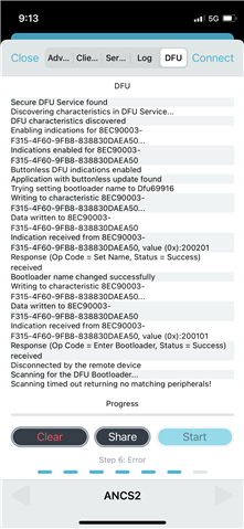

    Are the hex files you uploaded supposed to run on a nRF52 DK board? I tried to program them to a 52 DK here, but it did not start to advertise.
    Also, have you tried performing DFU from the Bluetooth low energy app as well, and in that case, what error did you get?
  • The hex files I uploaded run on a nRF52832 customer board. I try to use iOS nRF Connect APP to perform DFU. But it failed with "scanning timeout returning no matching peripheral". Why no bootloader log messages after BLE_DFU_EVT_BOOTLOADER_ENTER_PREPARE event?
    The following is log messages of nRF52832 device.

  • Please check if the device still advertises as "ANCS2" after the failed DFU attempt. This will indicate if the device failed to enter DFU mode or not after the "enter dfu mode" command (Message sequence charts).
  • Thanks for your reply! I have fixed this issue  by adding code to toggle POWER_UP GPIO pin to logic high. Besides I have another question that is how can I know when bootloader enter or leaving DFU mode. I would like to  to toggle POWER_UP GPIO pin to logic high when enter DFU mode and toggle POWER_UP GPIO pin to logic low when leaving DFU mode.
        uint32_t ret_val;
        nrf_gpio_pin_set(POWER_UP);
        nrf_gpio_cfg_output(POWER_UP);
