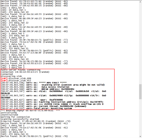

I've been getting into some pre-research on  new features of BLE5.3, and I choose LE Audio. I try running  unicast_audio_client/unicast_audio_server demos with my PCA10040 boards to see how it works.
Problem description:
unicast_audio_client just crashes everytime when it goes to"k_sem_take(&sem_sink_discovered, K_FOREVER)"

 the following snapshot is the uart log of unicast_audio_client when it crashed

  • Hello BigJim,
    I have successfully reproduced your errors. I believe this is a compatibility issue. The audio codec requires a lot of processing power, and is not suited for nRF52832. Additional information can be found in this answer to an older case.
    We don't provide support for LE audio development for the nRF52 series. Our recommended SoC for LE audio development is nRF5340, and our recommended development hardware is the nRF5340 Audio DK.
    We also recommend using our example application nRF5340 Audio as a starting point. The application documentation linked includes detailed information on how to get started with LE Audio development on nRF5340 Audio DK.
    Maria
