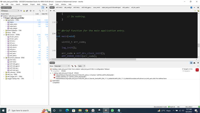

Hi All!
I am using nrf5 SDK 17.0.1 and using a radio test example to extend the range of nrf52833/20. Able to compile the example for nrf52833(pca10100).
Now the issue is that I migrated the code as per the instruction on nordic semi docs from pca10100 to pca10100e for nrf52820.
I am getting the following errors as mentioned in the image.
multiple definitions of `UARTE0_UART0_IRQHandler';
I disabled the Uart_enable in sdkconfig.h. Although the error removes but the controller is stuck and unable to run from the main.
I also attached the .emproject file where I tried to port the code from nrf52833 to nrf52820

Can you please help in this regard? thanks in advance.
    You should be able to solve this by setting UART_LEGACY_SUPPORT to 0 in sdk_config.h.
    With that, and this modified SES project file (from pca10100) I get the radio test project to build for nRF52820:

  • Hi
    Thank you so much for the response!
    Yes, I just tried UART_LEGACY_SUPPORT to 0 . After that error was removed but the controller was unable to run means no messages on uart send and receive and when I tried to debug it goes to the undefined state instead of starting from main.
    After that, I replaced SES file which you sent, then got many errors like
    "'NRF21540_PDN_PIN' undeclared (first use in this function)"
    means pca10112 is replaced by pca10100.
    Thanks in advance for the help!
