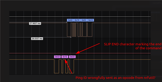

I am trying to get the example secure bootloader uart working on my nRF52832 development board but I am seeing a lot of TX errors on the RTT log output from the debug version of the bootloader. Thinking it might be related to flow control, I compiled my own version and disabled flow control but that didn't seem to resolve anything.
I captured a Saleae output which seems to show the nrfutil (version 6.1.6) is sending a single valid Ping request but the RTT log seems to indicate TWO Ping requests were processed for unknown reasons. I want to be able to trust my bootloader is going to work so I really need this to be reliable.
Can you please help provide any insights as to what might be going wrong?

    2022-08-09 14:56:38,662 SLIP: --> [9, 1]
    2022-08-09 14:56:38,666 SLIP: <-- [96, 0, 1, 1]
    2022-08-09 14:56:38,666 Serial: Unexpected Executed OP_CODE.
    Expected: 0x09 Received: 0x00
    2022-08-09 14:56:38,666 SLIP: --> [9, 2]
    2022-08-09 14:56:38,668 SLIP: <-- [96, 1, 5]
    2022-08-09 14:56:38,668 Serial: Unexpected Executed OP_CODE.
    Expected: 0x09 Received: 0x01
    2022-08-09 14:56:38,668 SLIP: --> [9, 3]

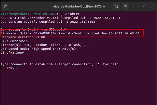

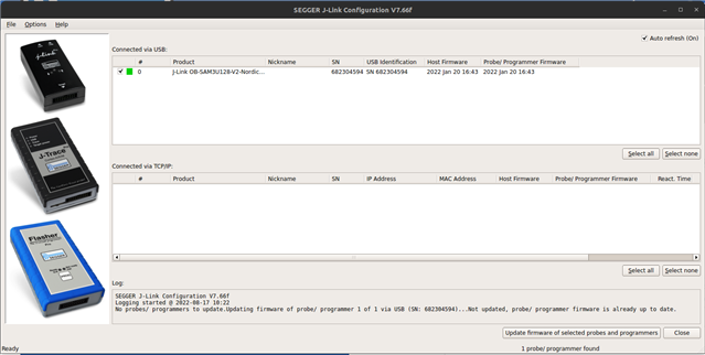

  • When using the pre-compiled bootloader images, did you try to keep the UART flow control enabled (i.e. not passing -fc 0 to nrfutil)? If flow control isn't enabled, then that may explain why the bootloader fails to receive the dfu requests correctly.
    Lack of flow control does however not explain why the host appears to be sending invalid command request in the salea trace:
    Edit: I would be nice if you could also check if the Jlink FW running on the DKs interface MCU is up to date as this is what provides the VCOM interface. You can do so by opening Jlink commander. The executable is named jlink.exe on windows and JLinkExe on Linux.
    If needed, the easiest way to update the FW is to install the latest version of nRF Command Line Tools and then try to flash something with the updated nrfjprog version. This should trigger a pop-up asking if you want to upgrade the FW.
  • From my Windows laptop, I see the following when I use my JLink commander executable:
    jlink
    SEGGER J-Link Commander V7.60a (Compiled Dec 16 2021 10:40:30)
    DLL version V7.60a, compiled Dec 16 2021 10:39:12
    Connecting to J-Link via USB...O.K.
    Firmware: J-Link OB-SAM3U128-V2-NordicSemi compiled Dec 3 2021 15:41:28
    Hardware version: V1.00
    S/N: 682818522
    License(s): RDI, FlashBP, FlashDL, JFlash, GDB
    VTref=3.300V
    Type "connect" to establish a target connection, '?' for help
    J-Link>connect
    Please specify device / core. <Default>: NRF52832_XXAA
    Type '?' for selection dialog
    Device>
    Please specify target interface:
    J) JTAG (Default)
    S) SWD
    T) cJTAG
    TIF>S
    Specify target interface speed [kHz]. <Default>: 4000 kHz
    Speed>
    Device "NRF52832_XXAA" selected.
    Connecting to target via SWD
    InitTarget() start
    InitTarget() end
    Found SW-DP with ID 0x2BA01477
    DPIDR: 0x2BA01477
    CoreSight SoC-400 or earlier
    Scanning AP map to find all available APs
    AP[2]: Stopped AP scan as end of AP map has been reached
    AP[0]: AHB-AP (IDR: 0x24770011)
    AP[1]: JTAG-AP (IDR: 0x02880000)
    Iterating through AP map to find AHB-AP to use
    AP[0]: Core found
    AP[0]: AHB-AP ROM base: 0xE00FF000
    CPUID register: 0x410FC241. Implementer code: 0x41 (ARM)
    Found Cortex-M4 r0p1, Little endian.
    FPUnit: 6 code (BP) slots and 2 literal slots
    CoreSight components:
    ROMTbl[0] @ E00FF000
    [0][0]: E000E000 CID B105E00D PID 000BB00C SCS-M7
    [0][1]: E0001000 CID B105E00D PID 003BB002 DWT
    [0][2]: E0002000 CID B105E00D PID 002BB003 FPB
    [0][3]: E0000000 CID B105E00D PID 003BB001 ITM
    [0][4]: E0040000 CID B105900D PID 000BB9A1 TPIU
    [0][5]: E0041000 CID B105900D PID 000BB925 ETM
    Cortex-M4 identified.
    J-Link>
    Also, I have tried both with and without adding the -fc 0 to nrfutil command line and I seem to see the same results.
    2022-08-15 09:16:46,332 Using board at serial port: COM15
    2022-08-15 09:16:46,338 Sending Application image.
    2022-08-15 09:16:49,869 SLIP: --> [9, 1]
    2022-08-15 09:16:49,870 SLIP: <-- [96, 0, 1, 1]
    2022-08-15 09:16:49,871 Serial: Unexpected Executed OP_CODE.
    2022-08-15 09:16:49,871 SLIP: --> [9, 2]
    2022-08-15 09:16:49,872 SLIP: <-- [96, 1, 5]
    2022-08-15 09:16:49,873 Serial: Unexpected Executed OP_CODE.
    2022-08-15 09:16:49,873 SLIP: --> [9, 3]
    2022-08-15 09:16:49,874 SLIP: <-- [96, 2, 1]
    2022-08-15 09:16:49,874 Serial: Unexpected Executed OP_CODE.
    Expected: 0x09 Received: 0x02
    2022-08-15 09:16:49,874 SLIP: --> [9, 4]
    2022-08-15 09:16:49,876 SLIP: <-- [96, 3, 5]
    2022-08-15 09:16:49,877 Serial: Unexpected Executed OP_CODE.
    Expected: 0x09 Received: 0x03
    2022-08-15 09:16:49,877 SLIP: --> [9, 5]
    2022-08-15 09:16:49,878 SLIP: <-- [96, 4, 5]
    2022-08-15 09:16:49,879 Serial: Unexpected Executed OP_CODE.
    Expected: 0x09 Received: 0x04
    2022-08-15 09:16:49,879 SLIP: --> [9, 6]
    2022-08-15 09:16:49,880 SLIP: <-- [96, 5, 2]
    2022-08-15 09:16:49,880 Serial: Unexpected Executed OP_CODE.
    Expected: 0x09 Received: 0x05
    2022-08-15 09:16:49,881 SLIP: --> [9, 7]
    2022-08-15 09:16:50,912 Serial: No ping response
    2022-08-15 09:16:50,912 SLIP: --> [9, 8]
    2022-08-15 09:16:50,914 SLIP: <-- [96, 7, 1, 131, 0]
    2022-08-15 09:16:50,915 Serial: Unexpected Executed OP_CODE.
    Expected: 0x09 Received: 0x07
    2022-08-15 09:16:50,915 SLIP: --> [9, 9]
    2022-08-15 09:16:50,918 SLIP: <-- [96, 0, 1, 1]
    2022-08-15 09:16:50,918 Serial: Unexpected Executed OP_CODE.
    2022-08-15 09:16:50,918 SLIP: --> [9, 10]
    2022-08-15 09:16:50,920 SLIP: <-- [96, 9, 1, 0]
    2022-08-15 09:16:50,921 SLIP: --> [9, 11]
    2022-08-15 09:16:50,924 SLIP: <-- [96, 10, 1, 50, 40, 5, 0, 0, 0, 64, 6, 0, 0, 160, 1, 0]
    2022-08-15 09:16:50,924 Serial: Unexpected Executed OP_CODE.
    Expected: 0x09 Received: 0x0A
    2022-08-15 09:16:50,924 SLIP: --> [9, 12]
    2022-08-15 09:16:50,926 SLIP: <-- [1, 0, 0, 16, 0, 0]
    2022-08-15 09:16:50,926 Serial: No Response: 0x01
    2022-08-15 09:16:50,926 SLIP: --> [9, 13]
    2022-08-15 09:16:51,958 Serial: No ping response
    2022-08-15 09:16:51,958 SLIP: --> [9, 14]
    2022-08-15 09:16:51,960 SLIP: <-- [96, 0, 1, 1]
    2022-08-15 09:16:51,960 Serial: Unexpected Executed OP_CODE.
    2022-08-15 09:16:51,960 SLIP: --> [9, 15]
    2022-08-15 09:16:51,962 SLIP: <-- [96, 14, 2]
    2022-08-15 09:16:51,962 Serial: Unexpected Executed OP_CODE.
    Expected: 0x09 Received: 0x0E
    2022-08-15 09:16:51,962 SLIP: --> [9, 16]
    2022-08-15 09:16:51,963 SLIP: <-- [96, 15, 2]
    2022-08-15 09:16:51,964 Serial: Unexpected Executed OP_CODE.
    Expected: 0x09 Received: 0x0F
    2022-08-15 09:16:51,964 SLIP: --> [9, 17]
    2022-08-15 09:16:51,965 SLIP: <-- [96, 16, 2]
    2022-08-15 09:16:51,965 Serial: Unexpected Executed OP_CODE.
    Expected: 0x09 Received: 0x10
    2022-08-15 09:16:51,965 SLIP: --> [9, 18]
    2022-08-15 09:16:51,966 SLIP: <-- [96, 17, 2]
    2022-08-15 09:16:51,966 Serial: Unexpected Executed OP_CODE.
    Expected: 0x09 Received: 0x11
    2022-08-15 09:16:51,966 SLIP: --> [9, 19]
    2022-08-15 09:16:51,967 SLIP: <-- [96, 18, 2]
    2022-08-15 09:16:51,967 Serial: Unexpected Executed OP_CODE.
    Expected: 0x09 Received: 0x12
    2022-08-15 09:16:51,967 SLIP: --> [9, 20]
    2022-08-15 09:16:51,969 SLIP: <-- [96, 19, 2]
    2022-08-15 09:16:51,969 Serial: Unexpected Executed OP_CODE.
    Expected: 0x09 Received: 0x13
    2022-08-15 09:16:51,969 SLIP: --> [9, 21]
    2022-08-15 09:16:51,973 SLIP: <-- [96, 20, 2]
    2022-08-15 09:16:51,973 Serial: Unexpected Executed OP_CODE.
    Expected: 0x09 Received: 0x14
    2022-08-15 09:16:51,973 SLIP: --> [9, 22]
    2022-08-15 09:16:51,977 SLIP: <-- [96, 21, 2]
    2022-08-15 09:16:51,977 Serial: Unexpected Executed OP_CODE.
    Expected: 0x09 Received: 0x15
    2022-08-15 09:16:51,977 SLIP: --> [9, 23]
    2022-08-15 09:16:51,980 SLIP: <-- [96, 22, 2]
    2022-08-15 09:16:51,980 Serial: Unexpected Executed OP_CODE.
    Expected: 0x09 Received: 0x16
    2022-08-15 09:16:51,980 SLIP: --> [9, 24]
    2022-08-15 09:16:51,982 SLIP: <-- [96, 23, 2]
    2022-08-15 09:16:51,982 Serial: Unexpected Executed OP_CODE.
    Expected: 0x09 Received: 0x17
    2022-08-15 09:16:51,982 SLIP: --> [9, 25]
    2022-08-15 09:16:51,984 SLIP: <-- [96, 24, 2]
    2022-08-15 09:16:51,984 Serial: Unexpected Executed OP_CODE.
    Expected: 0x09 Received: 0x18
    2022-08-15 09:16:51,984 SLIP: --> [9, 26]
    2022-08-15 09:16:51,986 SLIP: <-- [96, 25, 2]
    2022-08-15 09:16:51,986 Serial: Unexpected Executed OP_CODE.
    Expected: 0x09 Received: 0x19
    2022-08-15 09:16:51,986 SLIP: --> [9, 27]
    2022-08-15 09:16:51,988 SLIP: <-- [96, 26, 2]
    2022-08-15 09:16:51,988 Serial: Unexpected Executed OP_CODE.
    Expected: 0x09 Received: 0x1A
    2022-08-15 09:16:51,988 SLIP: --> [9, 28]
    2022-08-15 09:16:51,990 SLIP: <-- [96, 27, 2]
    2022-08-15 09:16:51,990 Serial: Unexpected Executed OP_CODE.
    Expected: 0x09 Received: 0x1B
    2022-08-15 09:16:51,990 SLIP: --> [9, 29]
    2022-08-15 09:16:51,992 SLIP: <-- [96, 28, 2]
    2022-08-15 09:16:51,992 Serial: Unexpected Executed OP_CODE.
    Expected: 0x09 Received: 0x1C
    2022-08-15 09:16:51,992 SLIP: --> [9, 30]
    2022-08-15 09:16:51,994 SLIP: <-- [96, 29, 2]
    2022-08-15 09:16:51,994 Serial: Unexpected Executed OP_CODE.

    2022-08-15 09:16:52,359 SLIP: <-- [96, 239, 2]
    2022-08-15 09:16:52,359 Serial: Unexpected Executed OP_CODE.
    Expected: 0x09 Received: 0xEF
    2022-08-15 09:16:52,359 SLIP: --> [9, 242]
    2022-08-15 09:16:52,361 SLIP: <-- [96, 240, 2]
    2022-08-15 09:16:52,361 Serial: Unexpected Executed OP_CODE.
    Expected: 0x09 Received: 0xF0
    2022-08-15 09:16:52,361 SLIP: --> [9, 243]
    2022-08-15 09:16:52,361 SLIP: <-- [96, 241, 2]
    Expected: 0x09 Received: 0xF1
    2022-08-15 09:16:52,361 SLIP: --> [9, 244]
    2022-08-15 09:16:52,363 SLIP: <-- [96, 242, 2]
    2022-08-15 09:16:52,363 Serial: Unexpected Executed OP_CODE.
    Expected: 0x09 Received: 0xF2
    2022-08-15 09:16:52,363 SLIP: --> [9, 245]
    2022-08-15 09:16:52,363 SLIP: <-- [96, 9, 1, 244]
    2022-08-15 09:16:52,363 SLIP: --> [9, 246]
    2022-08-15 09:16:52,365 SLIP: <-- [96, 9, 1]

  • Thanks. I see now that your J-link FW is a bit older than mine (J-Link OB-SAM3U128-V2-NordicSemi compiled Dec 3 2021 15:41:28 vs J-Link OB-SAM3U128-V2-NordicSemi compiled Jan 20 2022 16:43:31), and I found a fix mentioned in the Jlink release notes which sound like it may be related to the issue you are seeing:
    Version V7.60f (2022-01-25)
    J-Link OB SAM3U128 V2 NordicSemi
    1. VCOM: Tx (OB -> target) output was delayed by 1 character. 1st character that was sent to target MCU after COM port open was garbage. Introduced in V7.58e. Fixed.
    Please download and install V7.66f from https://www.segger.com/downloads/jlink/ and try to update the Jlink FW through the J-Link Configuration app:
  • Wow, I didn't realize how much of a difference having the right JLink firmware could have. This fix finally resolved the issue. Thanks again for all your help in this. Is there something the nrfutil can do to detect this issue? Could you post this somewhere on your website?
  • Thanks for confirming that it worked. I was really starting to run out of ideas as to what the problem could be, and I honestly did not expect the Jlink FW to be the culprit either.
    The release notes indicates that Jlink version V7.58e to V7.60e is affected by this, and we usually only test with the Jlink versions that are bundled with our nRF command line tool releases. Maybe this is why we (or me, at least) have not encountered this problem before..
    I think it might be challenging to make nrfutil distinguish a communication issue as seen here from a bootloader that is not responding properly to DFU requests. Now in retrospect, it should probably have been more obvious to me that problem was with the Segger VCOM as the logic traces you provided showed missing bytes in the DFU request packets.
