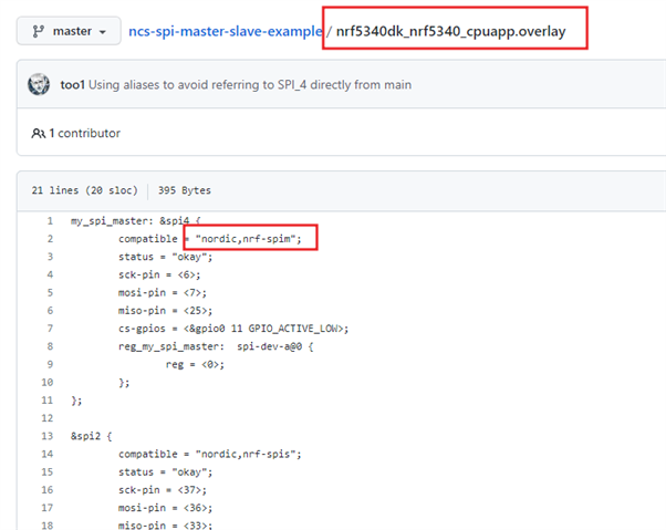

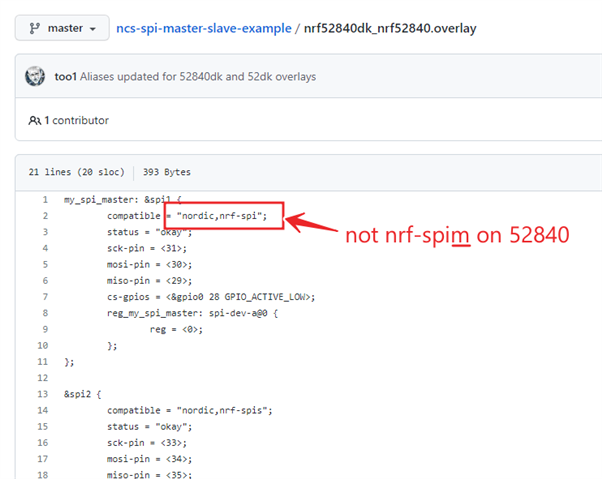

    I've also noticed a discrepancy in the example overlay files which might be a bug.
    Thanks again for your help
    This actually is not a bug. Referring to the &spi1 devicetree of e.g. the nRF52840DK:
    spi1: spi@40004000 {
    	compatible = "nordic,nrf-spi";
    	#address-cells = < 0x1 >;
    	#size-cells = < 0x0 >;
    	reg = < 0x40004000 0x1000 >;
    	interrupts = < 0x4 0x1 >;
    	status = "okay";
    	label = "SPI_1";
    	pinctrl-0 = < &spi1_default >;
    	pinctrl-1 = < &spi1_sleep >;
    The nRF53/nRF91 & nRF52 series are using different SPI drivers.
