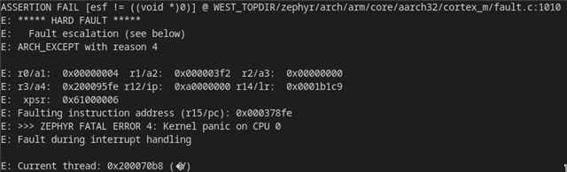

I'm looking for some help about Thread creation ... I try to start a Thread when my nrf52840 receive a particular message. This message is sent with BLE mesh and when it's the same node that sends and receives the message the thread is created but when it's two different nodes which send and receive the message, the thread creation failed and my node reset (Cf picture)
Here my code for the Thread creation :

static int bt_mesh_handle_message_request(struct bt_mesh_model *model, struct bt_mesh_msg_ctx *ctx, struct net_buf_simple *buf){
    printk("SERVER : receive request message \n");
	uint32_t receive_offset = net_buf_simple_pull_le32(buf);
	size_t receive_size = net_buf_simple_pull_le32(buf);
	printk("SERVER : receive offset = %d and size = %zu \n", receive_offset, receive_size);
	struct bt_mesh_datas_state datas_state_srv = {
		.address = SHARED_RAM_ADDRESS + receive_offset,
		.datas = (uint32_t *) datas_state_srv.address,
		.remaining_datas = receive_size
	struct k_thread my_thread_data;
	uint16_t addr = ctx->addr;
	k_thread_create(&my_thread_data, &my_thread_stack, STACKSIZE, thread_function, model, addr, &datas_state_srv, PRIORITY, 0, K_NO_WAIT);
	return 0;
What can cause this type of error ?

  • Hi Maureen,
    Using datas_state_srv.address in the initializer of datas.state.srv has undefined behavior.
    Code is passing dangling reference to new thread. When function returns, datas.state.srv is not alive and accessing it produces undefined behavior.
    my_thread_data has to outlive the thread, but it gets destroyed when function returns. You need to use k_thread_join before you it is safe to reuse/deallocate the k_thread variable.
    Dejan
