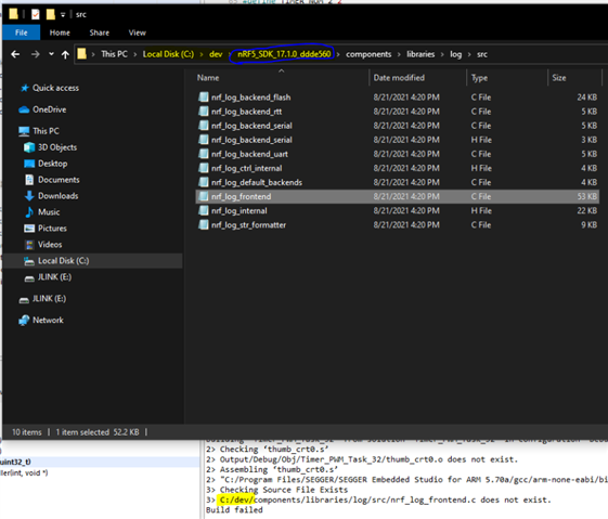

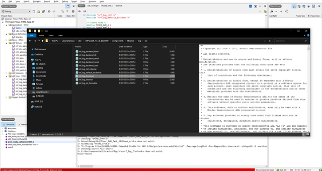

Hello all!
I coming across a strange problem, the emStudio does not want to accept the nrf_log_frontend file not matter the file is in the folder, under the sdk folders... have a look at the picture.
BTW what is the point of that file?
Best.

The path which Segger looks for the file is different from your target.
Try to remove the source file on the left-hand side and add it again.
Amanda
