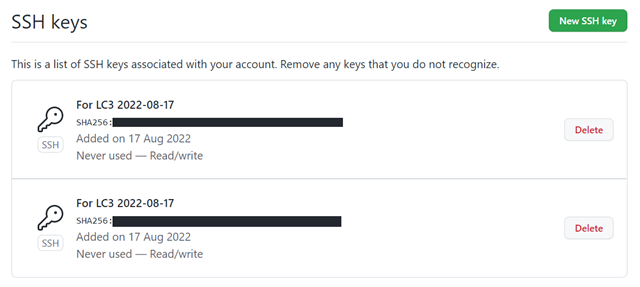

update failed for project sdk-lc3
Hello.
I had LC3 access granted.
I can access nrfconnect/sdk-lc3 on my web browser.
However, with bash, I get the following error and cannot build nRF5340_audio.
$ west config manifest.group-filter +nrf5340_audio
$ west update

ERROR: update failed for project sdk-lc3
How can I resolve this?
Gotoda
  • I tried changing the network environment, but the error still appears (The error message is slightly different).
    $ west update

    === updating sdk-lc3 (modules/lib/lc3):
    --- sdk-lc3: fetching, need revision c47d9ee21c9cd8626a903c2e2f0c80c0920a1eb8
    Username for 'https://github.com': masanorigotoda
    Password for 'https://[email protected]':
    remote: Support for password authentication was removed on August 13, 2021.
    remote: Please see https://docs.github.com/en/get-started/getting-started-with-git/about-remote-repositories#cloning-with-https-urls for information on currently recommended modes of authentication.
    fatal: Authentication failed for 'https://github.com/nrfconnect/sdk-lc3/'

  • HI,
    I added a new SSH key to my GitHub account.
    But I get the same error when running "west update".
    I get the following message, what does it mean?
    Gotoda
    It turns out that you must use a Git access token instead of an SSH key for this.
    Another alternative is to download the sdk-lc3 repo manually, and extract it to modules/lib/lc3, and then run west update again.
    Sigurd Hellesvik
  • Thank you.
    Using a Git access token resolved the issue.
