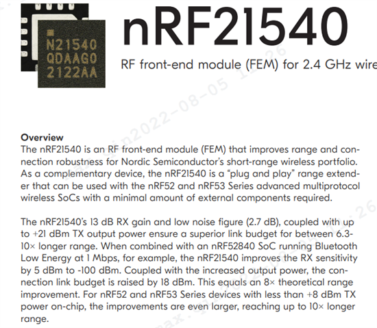

A little mistake of the specification of nRF21540
As described in the brief spec of nRF 21540:
the nRF21540 improves the RX sensitivity by 5 dBm to -100 dBm.
5dBm should be 5dB,you can't make a simple plus/minus equation to calculate the RF power.
          -95dBm-5dBm=-100dBm  (Wrong)
          -95dBm-5dB=-100dBm (Right)
www.nordicsemi.com/.../nRF21540-PB-v2.0.pdf
