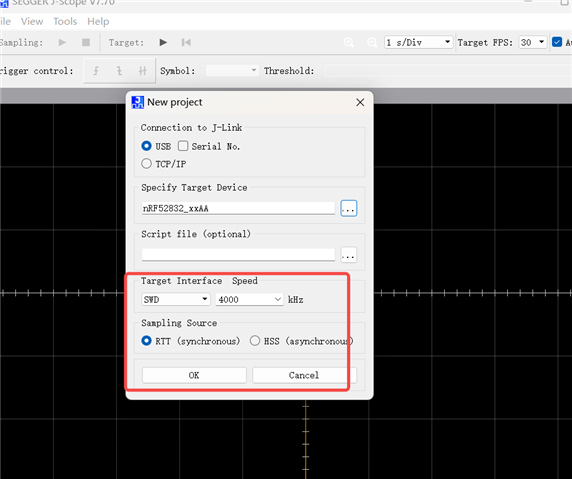

zephyr with J-scope , when use swd RTT mode, always get "Failed to start RTT Sampling."
Hi,everyone:
I tried HSS mode, but it can't meet my needs.
When I use RTT mode, the configuration is as follows

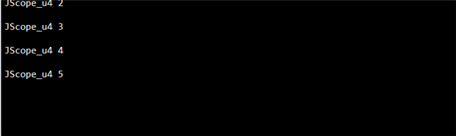

test code:
	uint32_t  zd = 0;
	while (true)
        zd++;
		LOG_PRINTK("JScope_u4 %d\n", zd);
		k_sleep(2000);
RTT viewer:

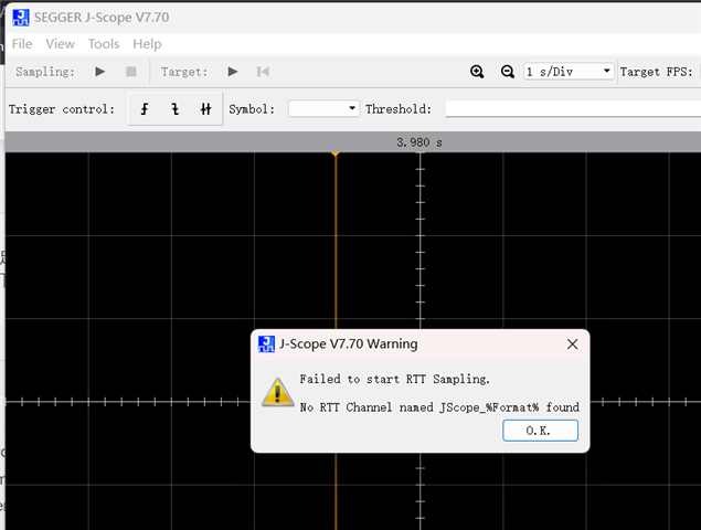

but, J-scope has been reporting the following errors
