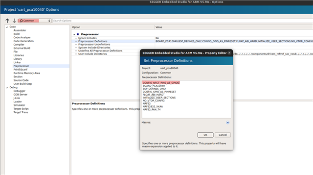

Hello All,
I have ported the UART example (<InstallFolder>\examples\peripheral\uart) on top of blinky in nicla sense hardware. The TX is working only when rx pin is set as "UART_PIN_DISCONNECTED".
The TX is also working if I comment out the below code portion.
// Turn on receiver if RX pin is connected
if (p_comm_params->rx_pin_no != UART_PIN_DISCONNECTED)
return nrf_drv_uart_rx(&app_uart_inst, rx_buffer,1);
Also I am not able to use the on chip debugger, if uart module enabled/initialized.
I assume the code is entering into app_error_fault_handler() when RX is enabled.
I have also verified the PIN_CFN.

    Please try to comment the "APP_ERROR_HANDLER(p_event->data.error_communication);" line in uart_error_handle() and see if that allows you to run the program with RX enabled.
    The APP_UART_COMMUNICATION_ERROR is often triggered if the UART RX pin is left floating.
    Vidar

    Also can you please clarify the expected UART RX pin state. Has it to be handled in the schematics ? I tried configuring the RX pin as input and pulldown before UART init. It does not work.

    I have tried configuring the RX pin as "nrf_gpio_cfg_input(RX_PIN_NUMBER_NICLA,NRF_GPIO_PIN_PULLUP)" after calling APP_UART_FIFO_INIT.
    Also tried modifying UART driver portion that configures RX pin (Fun: apply_config, File: nrfx_uart.c).
    The reception is not happening. Also observed that, in event handler "APP_UART_COMMUNICATION_ERROR" is getting triggered.

    The problem does not seem to be caused by a floating input since APP_UART_COMMUNICATION_ERROR still gets raised after you have enabled pull-up on RX, but rather that the transmitter is sending an "invalid" packet to your device. If you have a logic analyzer or scope available, you could try to probe the bus lines to verify that the baudrates match on both sides.
  • Hi Vidar,
    I shall check and update you. Since TX is working for both 9600 and 115200, is there any chance of baud rate issue. I have verified TX with putty and hterm.
    Rx test point is available in the board. Could you please let me know how to validate the baudrate / activity on RX pin using a logic analyzer.
