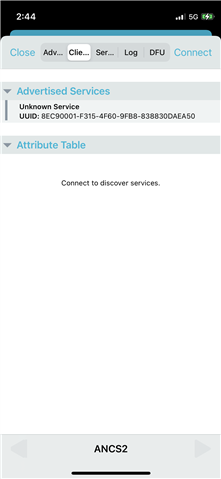

iOS nRF Connect doesn't show Nordic UART service in advertised services
nRF52832 firmware already support Nordic UART service. How to add Nordic UART service to advertising packets?

    Please look at the advertising_init() function in the SDK\examples\ble_peripheral\ble_app_uart example. It will add the Nordic UART Service UUID to the scan response packet.
