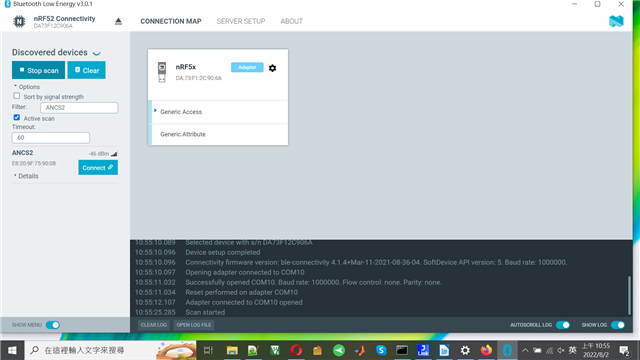

How to prevent nRF52832 device to enter sleep mode?
I found after a while I can't scan BLE device "ANCS2". Since I don't implement wake up mechanism, how to prevent  nRF52832 device to enter sleep mode?

  • I have removed calling  _sleepModeEnter() and calling advertisingStart() when _advertisingEvtHandler() handles BLE_ADV_EVT_IDLE event. Do you think it is good idea?

    Are you able to find the device advertising if you remove the filter?
    Yes, this is fine. The advertising module will go to IDLE state after it has iterated through all the enabled advertising states and no connection requests has been received. Restarting advertising when it has reached the IDLE state is ok.
