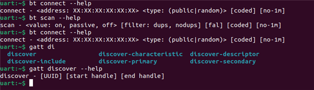

    If you haven't alread, I would suggest you try Bluetooth shell example to see if maybe does what you want. It's mainly used for testing in the Zephyr projet, so documentation for it a bit lacking, but should still be possible to use. You can add the --help argument to check what input parameters a particular command expects as shown below.
    UART serial client connected to Bluetooth shell sample

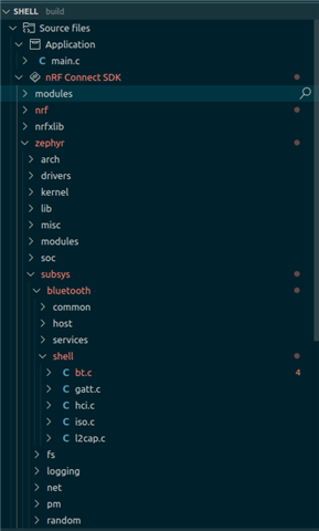

    Thanks, I understand your use case now. I agree that the shell sample can be a bit complicated to use. Still, if you want to see how the commands are implemented, you can have a look at the files in zephyr/subsys/bluetooth/shell.
