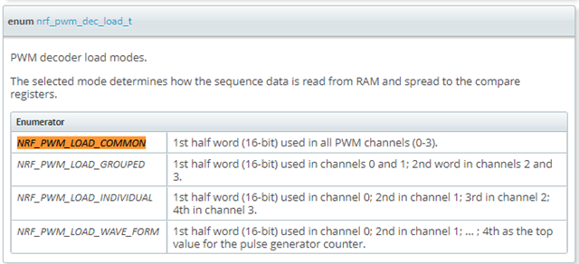

BLE Blinky App with Neo pixel WS2812 driver incorrect led outputs
Good day
I have been trying to incorporate the WS2812.c from the zigbee lightbulb example (no soft device) with the BLE_Blinky example (with soft device) SDK v 17.2 PCA10059 Dongle. my original post where I started project NRF52840DK driving Neopixel is flickering - Nordic Q&A - Nordic DevZone - Nordic DevZone (nordicsemi.com). After much trial and error I have manage to get a ring of 10 NEO pixels to display while keeping the BLE_Multilink Blinky example intact and working. I suspect a timer issure  and was wondering how I would go about to resolve. I suspect a combination of the softdevice, BLE and Timer_0   that is the cause of incorrect Neopixel display.
In original example drv_ws2812_set_pixel_all(uint32_t color)  and drv_ws2812_set_pixel(uint32_t pixel_no, uint32_t color)  works perfectly and the COLOR and  LED_PIXEL_NO lights up correctly,
But in the code below where I am using the WS2812 driver with softdevice the above functions behave differently.
//                  LED 0  LED 1  LED 2    LED 3     LED 4     LED 5    LED 6      LED 7     LED 8      LED 9
//                  G R B  G R B  G R B    G R B     G R B     G R B    G R B      G R B     G R B     G R B
//uint32_t pixel_no 0|1|2, 4|5|6, 8|9|10, 12|13|14, 16|17|18, 20|21|22, 24|25|26, 28|29|30, 32|33|34, 36|37|38
//drv_ws2812_set_pixel(pixel_no, uint32_t color ); //where uint32_t color has almost no influence
This switch on all the neo pixels but the color is completely incorrect. almost no red, yellow or green, mostly shades of blue (if I cycle
drv_ws2812_init(LED_CHAIN_DOUT_PIN);
    drv_ws2812_set_pixel_all(RGB_value);
    printf("RGB_value %d\n",RGB_value );
    drv_ws2812_display(NULL, NULL);
    RGB_value = RGB_value + 100;
    nrf_delay_ms(10); // to slow down the colors to see what value is what color

  • I have moved drv_ws2812_init(LED_CHAIN_DOUT_PIN) out of the while loop and into the init/setup loop to run once prior.
    It does not work at all after that. I would agree that it only needs to be called once, could it be that another function is also using PWM or P0.29/P0.31
    static uint32_t pwm_init(uint8_t dout_pin)
        nrfx_pwm_config_t pwm_config = NRFX_PWM_DEFAULT_CONFIG;
        pwm_config.output_pins[0] = NRFX_PWM_PIN_NOT_USED;
        pwm_config.output_pins[1] = dout_pin;
        pwm_config.output_pins[2] = NRFX_PWM_PIN_NOT_USED;
        pwm_config.output_pins[3] = NRFX_PWM_PIN_NOT_USED;
        pwm_config.load_mode      = NRF_PWM_LOAD_INDIVIDUAL;
        // WS2812 protocol requires a 800 kHz PWM frequency. PWM Top value = 20 and Base Clock = 16 MHz achieves this
        pwm_config.top_value      = 20;
        pwm_config.base_clock     = NRF_PWM_CLK_16MHz;//NRF_PWM_CLK_16MHz;
        return nrfx_pwm_init(&m_pwm, &pwm_config, pwm_handler);
  • I have manage to solve the problem. I changed the LOAD_INDIVIDUAL to LOAD_COMMON in drv_ws2812.c
        pwm_config.load_mode      = NRF_PWM_LOAD_COMMON;//NRF_PWM_LOAD_INDIVIDUAL;
    Both drv_ws2812_set_pixel_all(uint32_t color)  and drv_ws2812_set_pixel(uint32_t pixel_no, uint32_t color)  works as expected.  drv_ws2812_init(LED_CHAIN_DOUT_PIN) also now just need to be called once.
    BLE is still intact.
    Thanks for your help  Sigurd.
