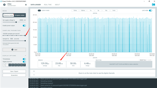

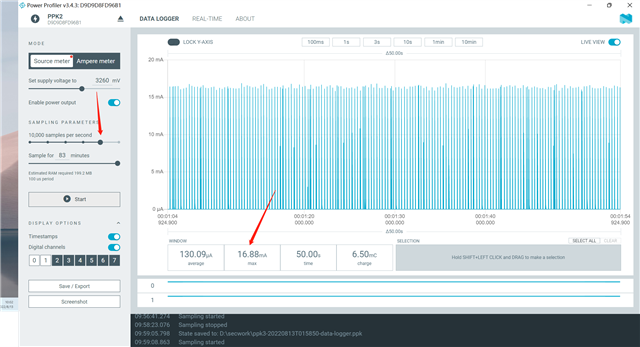

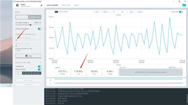

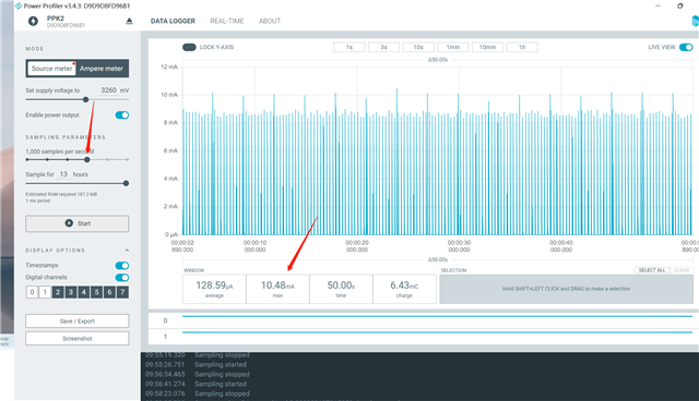

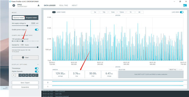

Thanks, can you try using the Ampere meter mode as well if you have a pin to put the Vin on? Can you also try to turn the sample/sec parameter down one notch as well and upload that .ppk file.

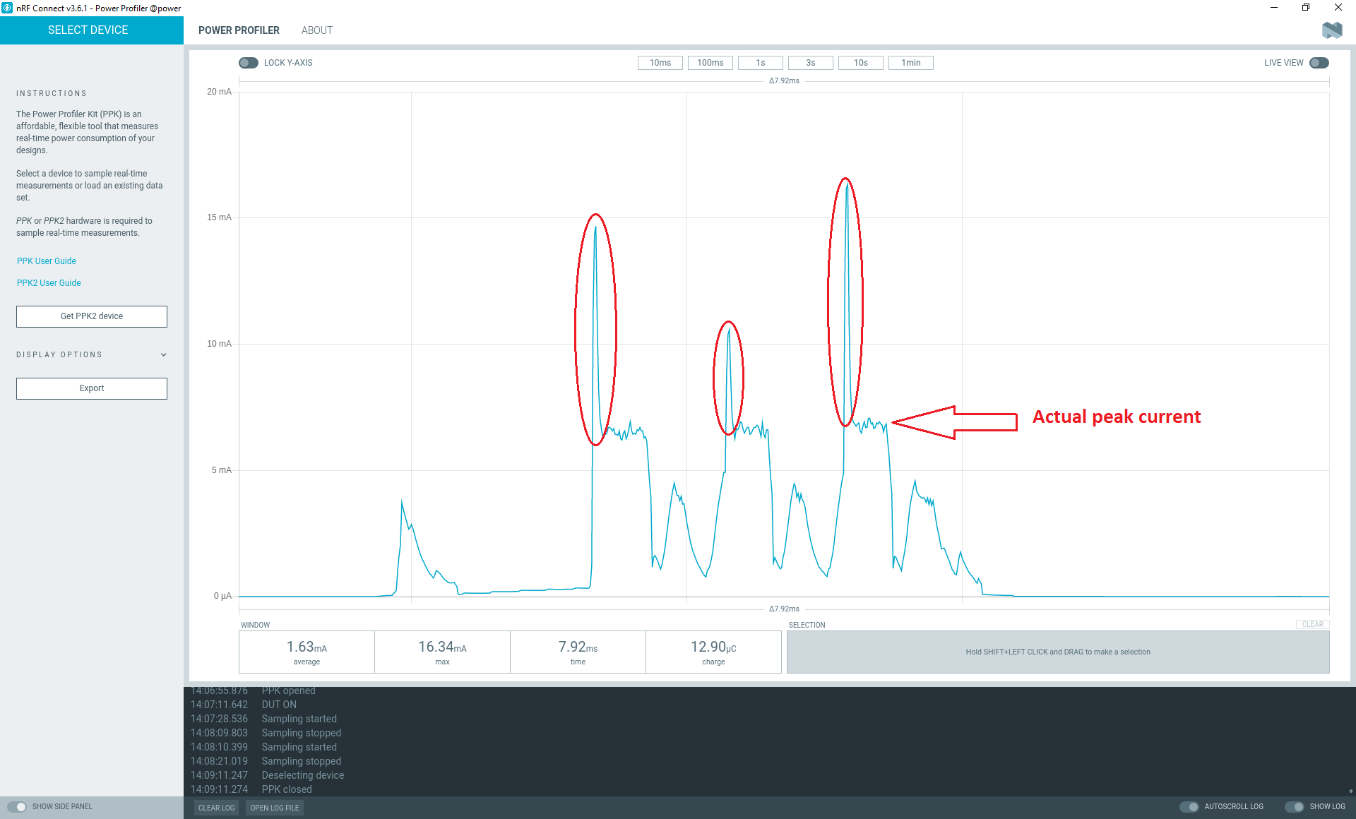

Hi

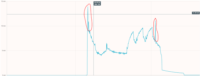

Thank you for sharing. This was more of what we could expect, although still not entirely. I'm interested in how you have set up your advertising, what advertising parameters, and LF clock source you're using, as these advertising events are not exactly as expected. The two spikes I have ringed around here are definitely spikes caused by noise from either USB or the level shifter, you can use a clean voltage source to get rid of some of this at least, but the level shifter spikes would still be there.
Simon

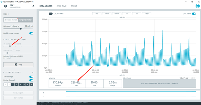

PS: An expected advertising event would look something like this (with voltage spikes):
