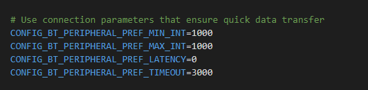

    Have you tried the nRF Connect Android app and see if it disconnects? Where is the error printed, is it on your phone or directly from the nRF? Error 0x13 indicates that it's the peer that does the disconnection. The central doesn't usually disconnect because of the connection parameters suggested by the peripheral, since it's the central itself that decides the connection parameters.
    I modified the peripheral uart example to set connection parameters to 1250 ms and it worked without any disconnections:
    regards
