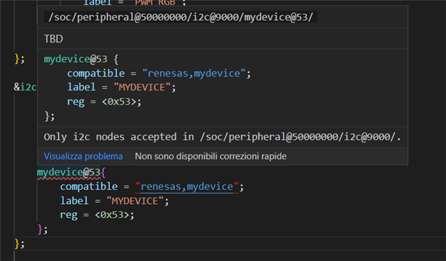

My development requires new device binding and I want to share the steps followed and my issue.
My device is Renesas and commuicate via I2C protocol.
Based on vendors available,I have to proceed with the following step:
  1. create a new file renesas,mydevice.yaml
  2. Copy it in my root path "dts\bindings\sensor"
  3. In .dts file:
&i2c1 {
	status = "okay";
	sda-pin = <34>;
	scl-pin = <35>;
	mydevice@53{
		compatible = "renesas,mydevice";
		label = "MYDEVICE";
		reg = <0x53>;
where i2c1 is the node defined in .dtsi.
Well, I can build my project and I can use my custom library to communicate with it.
My issue regarding the device that provide also an interrupt when data is ready, then how can I proceed?
  • Must I define the interrupt properties in my binding file? If yes, what is the best way?
  • Or, Can I maintain the current implementation and manage interrupt in .dts as gpio?
Thank you in advance.
