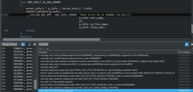

but on DK2
Log:
<t:      18835>, app_level.c,  295, SET: Level: 0  delay: 0  tt: 0  req-delta: 0  trans-type: 0
<t:      18840>, main.c,  773, Transition time: 0, Target level: 0, Transition type: 0
<t:      18844>, app_level.c,  239, Transition completed: Present-L: 0  Target-L: 0
<t:      88095>, main.c, 1405, Mesh device identification started.
<t:     184843>, app_error_weak.c,  115, Mesh error 7 at 0x00000000 (:0)

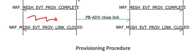

To pin down the Mesh error 7 seems to come from the SD140 while changing the state from "device identification started cb" to "Provisioning completed"
Question:
pb_remote server model should be running byside of app level and scene server.
According to the Communication handshaking provisioning should be confimed by the server.
https://infocenter.nordicsemi.com/index.jsp?topic=%2Fcom.nordic.infocenter.meshsdk.v5.0.0%2Fmd_doc_user_guide_modules_provisioning_pb_remote.html
How has the PB Remote Server to be integrated in the service model(s) on the Mesh side?

    according to the Breakpoint on pb_remote_server_enable() provisioning_complete_cb() is not called due the Mesh error.
    first run -> error after Provisioning complete
    reboot -> device has  device adress 0x1337 and "m_device_provisioned" is true
    but since pb_remote_server is not properly set up, so i guess,  there is still no function
    first run ( erase mcu done before):
    <t:      11464>, main.c, 1397, Initializing and adding models
    <t:      11468>, main.c,  791, remote Level server handle: 2
    <t:      11472>, main.c,  796, App Level Model handle: 3
    <t:      11476>, main.c,  814, App DTT Model handle: 5
    <t:      11480>, main.c,  821, App Scene Model handle: 7, Element index: 0
    <t:      11528>, main.c, 1439, Data in the persistent memory was corrupted. Device starts as unprovisioned.
    <t:      11532>, main.c, 1440, Reboot device before starting of the provisioning process.
    <t:      16737>, mesh_app_utils.c,   66, Device UUID (raw): 4814A81088874AA89A89EC236FE7D867
    <t:      16741>, mesh_app_utils.c,   67, Device UUID : 4814A810-8887-4AA8-9A89-EC236FE7D867
    <t:      16752>, main.c, 1605,
    		 RTT 1) The brightness of the LED 1 decresses in large steps.
    		 RTT 2) The brightness of the LED 1 incresses in large steps.
    		 RTT 4) Clear all the states to reset the node.
    <t:      36884>, app_level.c,  295, SET: Level: 0  delay: 0  tt: 0  req-delta: 0  trans-type: 0
    <t:      36889>, main.c,  773, Transition time: 0, Target level: 0, Transition type: 0
    <t:      36893>, app_level.c,  239, Transition completed: Present-L: 0  Target-L: 0
    <t:    1237849>, main.c, 1407, Mesh device identification started.
    <t:    1268197>, app_error_weak.c,  115, Mesh error 7 at 0x00000000 (:0)
