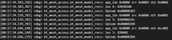

Not able to receive status messages published by onoff Server using message context instead of default publish parameters set by provisioner
I am trying to send status messages to a Client model with a specific unicast address on one node. This node's parent element has both generic onoff server and client models implemented. All onoff server and client models across all nodes are configured to publish and subscribe to specific group addresses (0xc000 and 0xc001 respectively). When I try to publish a status message to this client model using the message context (with the destination address as the elements unicast address) instead of using the default publish parameters, it does get received by the access layer but, not by the client model (breakpoint at status handler does not hit).
When I publish a get/set message to the server model in the same element, using the same context instead of the default publish parameters, it gets received by the model (breakpoint at get/set handlers get hit). Am I missing something here? Please suggest.
I am working with NCS 1.9.1 on nRF52480 DK's
    This seems a bit odd.
    What example are you basing your project on? Can you give more details on what you have done so far? What modifications have you done?
    Are you getting any error codes? It is received by the access layer so I assume it is being sent successfully from the server.
    Can you elaborate on this?
  • I have attached my modified main.c of Provisioner, Model_handler c files for both switch and light examples. This is just to test if the message can be address to the provisioner node only. The unicast address for the provisioner element is 0x0001
    below is the provisioner node main.c

    		struct bt_mesh_msg_ctx m;
    		m.addr= 0x0001;
    		m.app_idx= 0;
    		m.send_rel=false;
    		m.send_ttl= BT_MESH_TTL_DEFAULT;
    		err = bt_mesh_onoff_cli_set_unack(&buttons[i].client, NULL, &set);

    Can status messages be sent randomly? or do they get accepted only after a get/set message gets sent first? Please advice
