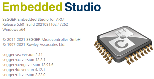

When compiling the codes of PB_remote client and server in the path of "Nordic nrf52xxx\nrf5_SDK_for_Mesh_v5.0.0_src\examples\pb_remote", there are some wrong error message as below.
Could anybody provide the method fixing the error message? Thanks your help.
Below is segger version for compiler

    The unmodified example shouldn't give you this error. I guess you did some modifications? Is either MESH_FEATURE_GATT_PROXY_ENABLED or MESH_FEATURE_PB_GATT_ENABLED set to 1 in your nrf_mesh_config_core.h or nrf_mesh_config_prov.h respectively?
    If so, did you do that on purpose? If not, I guess you can revert them both back to 0. If you did intentionally set this, then you need to include some more files. Without having looked it up, you can refer to some of the examples already using this feature, such as the examples\light_switch\server, which sets the NRF_BLE_CONN_PARAMS_ENABLED to 1 in it's app_config.h.

      Thanks your hintsand I redownload new MESH_SDK(nrf5sdkformeshv500src) and recompiling these codes successfully.
