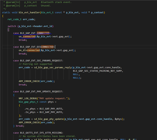

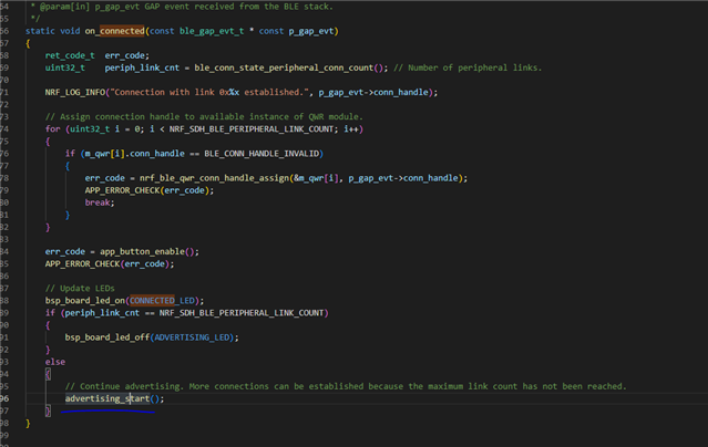

ble_advertising_start() failed with errCode 0x8
I would like to start advertising after BLE connection disconnected. But ble_advertising_start() return errCode 0x8.
static void ble_evt_handler(ble_evt_t const* pBleEvt, void* pContext)
    switch (pBleEvt->header.evt_id)
            NRF_LOG_INFO("BLE_GAP_EVT_DISCONNECTED\n");
            advertisingStart();

  • Hi there,
    Error code 8 from ble_advertising_start() is NRF_ERROR_INVALID_STATE and is return if the module is not initialized.
    Which is strange, since you're using the module when you advertised in the first place.
    Can you share your whole project?
    regards
    Jared
  • Does advertising stop after connecting created?
  • Yes, advertising will stop after a connection has been created.
  • Do you have suggested example for testing advertising? I am add my modification to that example and then share source code to you.
