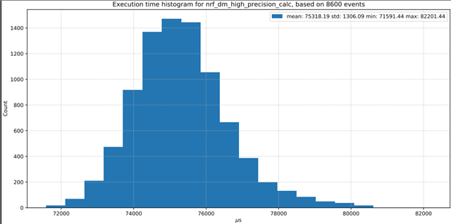

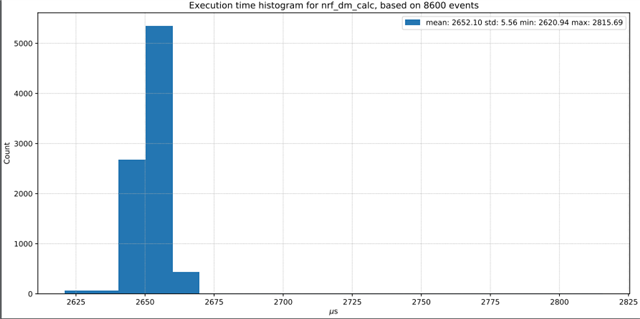

    Yes, you should increase CONFIG_DM_MIN_TIME_BETWEEN_TIMESLOTS_US.
    As for the values, I have contacted the developers and got the execution time graphs. Both test were done on nRF52833, so it should be similar for nRF52840.
    Just be wary that they were made in a static environment. In a dynamic, wireless environment the values may differ, so just treat them as estimates.
    Here is one for nrf_dm_calc():
    And one for nrf_dm_high_precision_calc():
    So maybe something like 100000+ µs would be a good value to start with.
