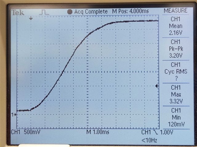

    Vdd waveform from a good sample (bad sample is the same):

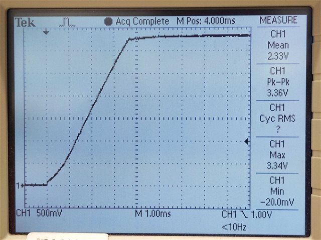

    nreset waveform for a good sample:

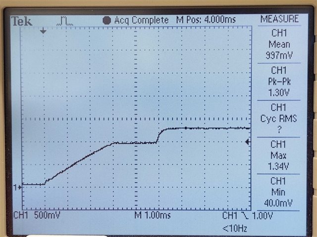

    nreset waveform for a bad sample:
    At this time we consider the issue to be caused by a faulty capacitor.
    In future builds we will remove the circuit and disable the reset pin in firmware.
  • Thanks for sharing measurement, VDD rise time is good, but it's indeed something suspicious about the voltage on nreset, not something I have seen earlier. Based on your current description and fix I don't think it's anything faulty with the nRF52832, so I don't see a need to transfer this case to QA and ask for an RMA to return samples here for ATE retest. If you later find samples that are permantely stuck in reset or other symptoms please let us know (and possible with a link to this case) so we may follow up.
