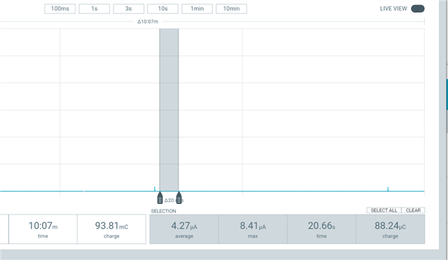

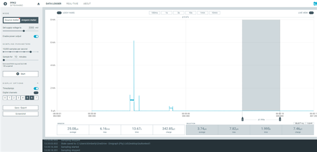

We have recently acquired some new nrf5340DK's and we suddenly noted that the SYSTEM ON LOW POWER current increased from about 5 uA to about 25 uA.

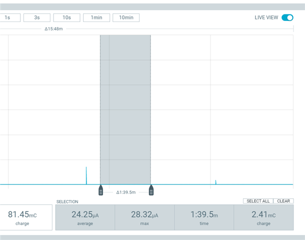

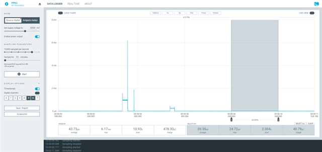

Attached below is an example project we received which we are using as reference. When uploading this onto the new DK 2.0.0 hardware, we are measuring a current of 24.25uA:
When uploading the exact same firmware onto the older 1.0.0 hardware, we are measuring about 5uA:

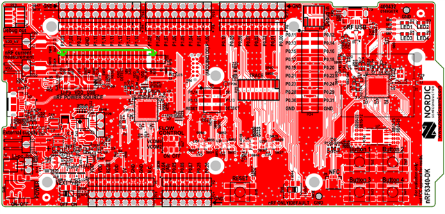

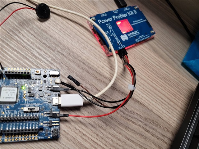

Our hw setup is as follow, with SB40 cut:
