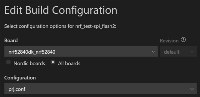

I have a nRF52840 DK and I am using Zephyr Version 2.0.0.
I am trying to test the SPI Flash example found in the zephyr/samples/drivers/spi_flash directory.

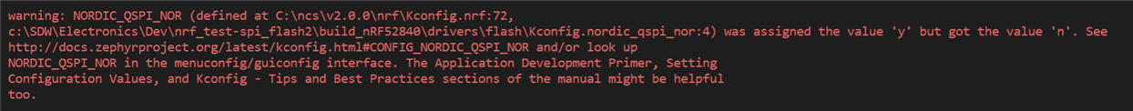

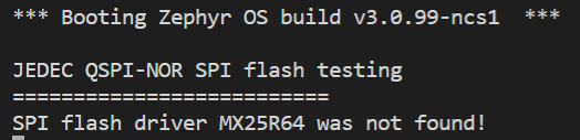

The sample successfully compiles and flashes to my DK however there is an error when the application runs.
1) Is there something in the settings I am missing to get this working?
