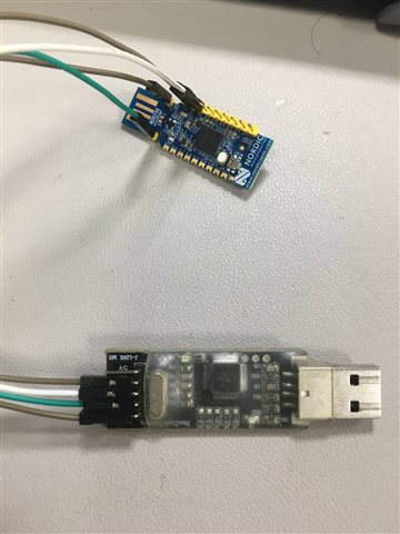

Hi, I'm new to the NRF Connect SDK, as well as nRF Connect for Desktop.
I have a nRF52840 Dongle and a nRF52840DK.
The nRF52840DK worked well. But I could not program the nRF52840 Dongle.
I tried to connect it with the J-Link USB. But after I successful programed the device using J-Flash Lite, the Dongle seem not able to work.
Can you help me? I do not know what I missed?
Does the Dongle need a special boot image?
And It should be kind if there is a Guide for programming the NRF Connect SDK output .hex file into direct SOCs, not to the DK or Dongle boards.
  • Dears, I had done bring back the Dongle with "Revert to production bootloader".
    Many thanks.
    I was not able to use the DK, but a Jlink could make it.
    First, cut the SB2, soldered the SB1
    Second, connected the Dongle with the Jlink as the photo.
    Dongle ============ Jlink
    VDD OUT ---------------> 3.3V
    GND ----------------------> 3.3V
    SWDCLK ----------------> TCK
    SWDIO--------------------> TMS
    Third, connect the Jlink to the computer. Using the nRF Connect Programmer, flash the graviton_bootloader in pca10059_bootloader.zip
