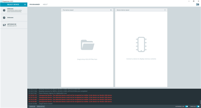

    When you are attempting to program the dongle, which steps are you following? Have you tried the steps in the section "Program application using nRF Connect Programmer" in the nRF52840 Dongle Programming Tutorial. Are you able to follow these steps? If this way to program the dongle does not work, where does it fail?
    Are you able to see or select the Dongle in Programmer? Could you please take a screenshot from Programmer?

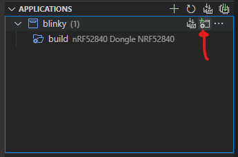

    Building Blinky for the dongle using nRF Connect SDK and VS Code:
    You might already have done this, however, here are a few things to check:

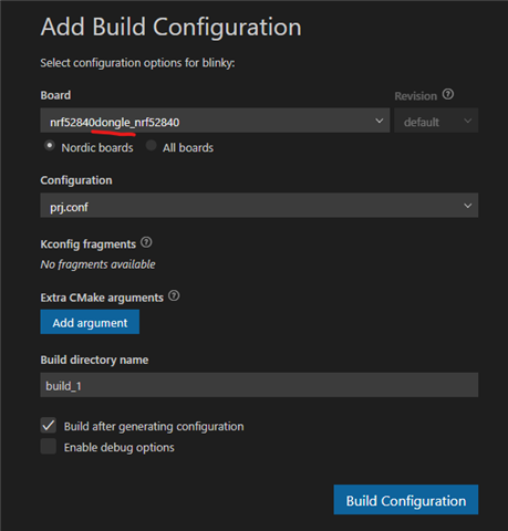

    When you built the Blinky sample with nRF Connect SDK, did you remember to select the correct board when you added the Build Configuration?
    Your application might currently be configured for the DK. If so, you could either change to the dongle, or add another configuration:

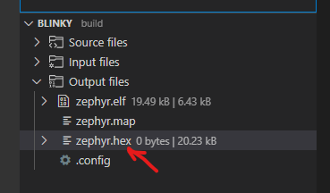

    After you have built your application for the nrf52840dongle_nrf52840, you may find the .hex to program here:
    Program zephyr.hex to the dongle using the steps in "Program application using nRF Connect Programmer" in the nRF52840 Dongle Programming Tutorial.

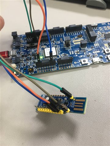

    I am folowing the "Recover after an accidental UICR erase" guide.
    I use the nrf52840DK to program, but I can not see the Dongle on nRF Connect Programmer
    This is how I connect the Dongle to the DK.
    The SB2 is cutted and the SB1 is connected.
