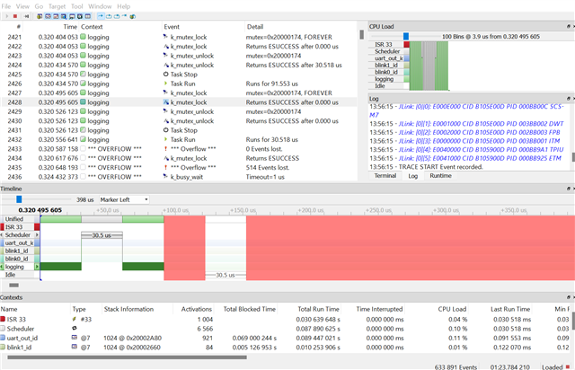

We are evaluating Segger SystemView for analyzing our embedded applications. However, we encountered occasional overflows in SystemView. These overflows are caused by the logging module when set to deferred logging. The application runs on an nRF52833DK, but I used an external J-Link debugger to gather the trace data over RTT, because of the limited speed of the J-Link on the DK (I tested this too).
I took this guide from Zephyr as an example to configure the SystemView and Kconfig. I replicated this issue with the basic thread example project.
I noticed SystemView logs show "SWD speed too high. Reduced from 15000 kHz to 7593 kHz for stability". Is this a limitation of the nRF52833?
Is there a way to disable the trace data from the logging module?
Would it help to get a more powerful J-Link (i.e., J-Link pro)?
Are there other settings I could modify to allow this to work?

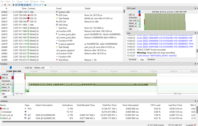

In the second image, only the setting `CONFIG_LOG_MODE_DEFERRED` changed to `CONFIG_LOG_MODE_IMMEDIATE`.
SystemView deferred logging:
SystemView immediate logging:
