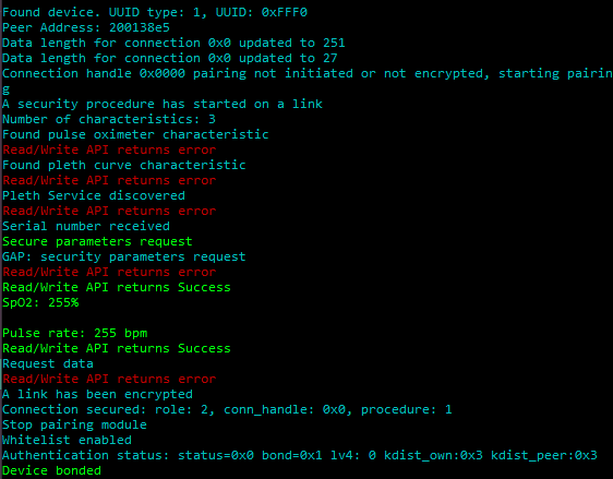

I am pairing the pulse oximeter with the central. They bond, the link is encrypted and the pulse oximeter is added to the whitelist. Here am I able to extract data from the peripheral. Logs shown in the image bellow

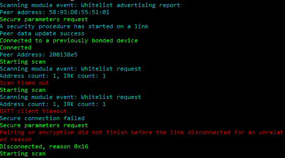

My problem is when the pulse oximeter is reconnected later. It is found via whitelist and triggers the events: PM_EVT_BONDED_PEER_CONNECTED and PM_EVT_CONN_SEC_START. This procedure, however, is interrupted and finished by a LE_GATTC_EVT_TIMEOUT event which causes the disconnection of the peripheral. Logs shown in the image bellow

  • In addition I would like to say that when the event PM_EVT_CONN_SEC_PARAMS_REQ happens, this is what I do:
        case PM_EVT_CONN_SEC_PARAMS_REQ:
              PRINT_RAW("Secure parameters request\n");
                // Allow pairing request from an already bonded peer.
                pm_conn_sec_config_t conn_sec_config = {.allow_repairing = true};
                pm_conn_sec_config_reply(p_evt->conn_handle, &conn_sec_config);
            }break;
