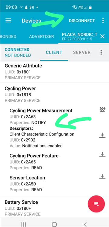

    Ok, so most likely the device never connects. You''ve probably put the UUID of your custom service inside the advertising packet which explains why you are able to see it. What are you using on the other side to scan the advertising packets? A mobile phone?

    My custom service connect, because I put the correct UUID.
    I'm using nrf connect app to see the services.
    I can't read the measurement values of my service. Analyzing my code, the function  ble_cps_measurement_send below was never called.
