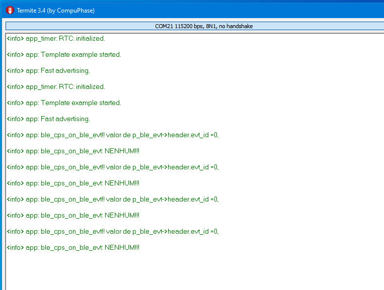

    I set the breakpoint and modified my code to debug and the event handler was called, but the evt_id return 0.
    void ble_cps_on_ble_evt(ble_cps_t * p_cps, ble_evt_t * p_ble_evt)
        NRF_LOG_INFO("ble_cps_on_ble_evt!! valor de p_ble_evt->header.evt_id =%u, ", p_ble_evt->header.evt_id);//todo debug
        case BLE_GAP_EVT_CONNECTED:
            on_connect(p_cps, p_ble_evt);
            NRF_LOG_INFO("ble_cps_on_ble_evt: BLE_GAP_EVT_CONNECTED ");//todo debug
            on_disconnect(p_cps, p_ble_evt);
            NRF_LOG_INFO("ble_cps_on_ble_evt: BLE_GAP_EVT_DISCONNECTED ");//todo debug
        case BLE_GATTS_EVT_WRITE:
            on_write(p_cps, p_ble_evt);
            NRF_LOG_INFO("ble_cps_on_ble_evt: BLE_GATTS_EVT_WRITE ");//todo debug
        default:
            // No implementation needed.
             NRF_LOG_INFO("ble_cps_on_ble_evt: NENHUM!!! ");//todo debug
    I cannot idenfitify wich part of the code the this value is changed, because the ble_evt_handler function in main.c works fine to connect and I can see the services in nrf connect app without values

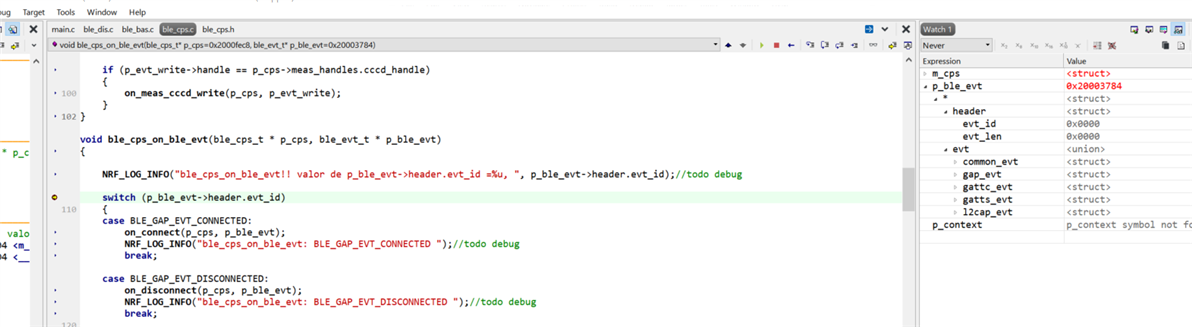

    Great, I can clearly see from your screenshot that it enters the ble event handler, but neither it or the log shows any CONNECTED event?
    It seems that you determine that you are connected because you're able to the see the services provided by the peripheral? Can you verify it by moving the breakpoint inside the BLE_GAP_EVT_CONNECTED switch case and see if it enters it?
    regards
    Jared

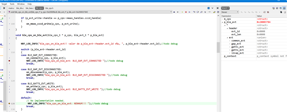

  • Hi Jared,
    I tried it several times finding the point of my code that set this value. I ran the code again to show you with the breakpoint inside the case and never entered.
    Regards
    Laerte
