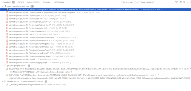

We are trying to use thingy52 as an transparent Gateway to Thingy91 and from thingy91 to publish data on internet through MQTT protocol.
on thingy52 we want to use Peripheral_uart example, this unmodifyed example give us a lot of build errors (NRF52DK_NRF52832)
on thingy91_nrf52 we want to use central_uart example, this unmodifyed example give us a lot of build errors(NRF9160DK_NRF52840)
We expect theese to build without any errors.
we then want an uart connection between Thingy91_NRF91 and Thingy91_NRF52.
On thingy91_NRF91 we want to use MQTT_simple example, This build and works fine to my MQTT broker.
Does this seams like an feasible solutions? any other examples we could as starting point?
why do the perifheral and central_uart example fails? 19 include errors++
please advice

    Thanks for quick repy.
    I instaled the sdk thrue toolchain manager in nrf connect for desctop.
    I am usinf SDK 2.0.2.
    I am using VS Code to build.
    i have not change any of the sdk files.
    The build logg:

    The build does not fail. The errors you see in the "Problems" tab here are not related to the building of applications, and are not even coming from the nRF Connect for VS Code extension. They are coming from the C/C++ extension and just means that IntelliSense is unable to find the files. So you can just ignore them. If the build failed you would have gotten a message about it failing in the output log.
    Marte
  • Hi Marte,
    In the peripheral_uart example i try to add an uart for local Communications to my sensor. Does the NRF52832 only have one uart? and does the NUS_UART service use this uart?
    Rune
  • Hi Rune,
    Yes, the nRF52832 only has one. You can see an overview over available peripherals on nRF52 series SoCs here: nRF52 Series.
    And yes, the Peripheral UART sample uses UART for the NUS service.
    Marte
