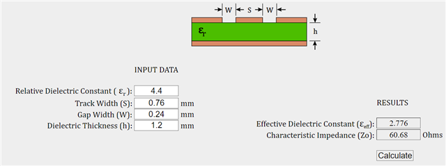

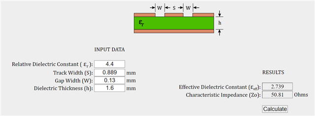

Last question for this post. The dongle has a grounded coplanar wave transmission line dimensions entered below which basically gives the target 50 ohms.
However, the DK grounded coplanar wave transmission line dimensions entered below are way off 50 ohms.
Is there a reason for this or have I got something very wrong/misunderstood?
 Any help on the above matters is appreciated, thank you.
    The important thing is that you do the calculations for you design, and that the transmission line is ~50 Ohm.
