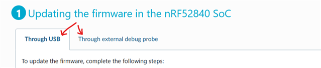

I am updating Nordic Thingy:91. I am following instructions on Nordic's DevZone web page: "Getting NB-IoT Demo running on Thingy:91
I have successfully updated modem using the latest firmware zip file. The nRFConnect for Desktop Programmer app successfully connects to the Thingy:91.
However, the device does not work without also loading NB-IoT demo application firmware. The web page does not spell out which hex files to upload.
Below is a list of the files contained in the firmware update zip file. Which hex files on this list do I need to upload to the device to make it work?
