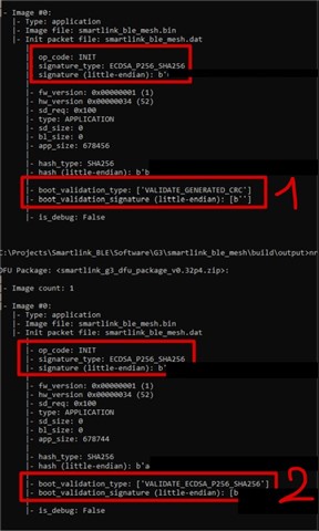

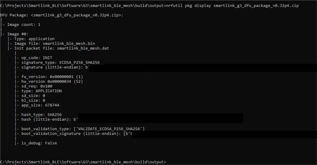

1. I made a test and got the Info from the packages with nrfutil pkg display and saw that to zip file for the bootloader is still with CRC validation, why?
the app is with the correct validation:
2. If I download the zip package of the APP with the --app-boot-validation VALIDATE_ECDSA_P256_SHA256, its working. But I can still download an App zip file with CRC validation. The same for the bootloader zip file. Why this? Do I have to use the nrfutil settings generate with the option --app-boot-validation and --sd-boot-validation with VALIDATE_ECDSA_P256_SHA256 aswell?
I expected that a zip file without the VALIDATE_ECDSA_P256_SHA256 is not valid and the update would be impossible, which is not the case.
Thanks for a feedback

    The only difference between the 2 zip files is the boot validation type, the signature of the file is ECDSA_P256_SHA256 o both zip files, even if I don't use the command:
    --app-boot-validation VALIDATE_ECDSA_P256_SHA256 --sd-boot-validation VALIDATE_ECDSA_P256_SHA256

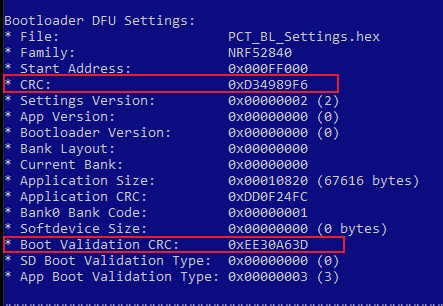

  • Hi
    I have a follow up question.... Who (application or nrfutil) is responsible for creating and inserting the CRC into the new image being uploaded over DFU?
    1. Does the application developer have to do some kind of post processing to inject this into a specific location in the generated output file
      OR
    2. Does the nrfutil tool calculate and inject this value into the merged HEX or DFU outputs that it generates?
    I also do not understand why the generated BL settings show two CRC fields/values e.g. below:

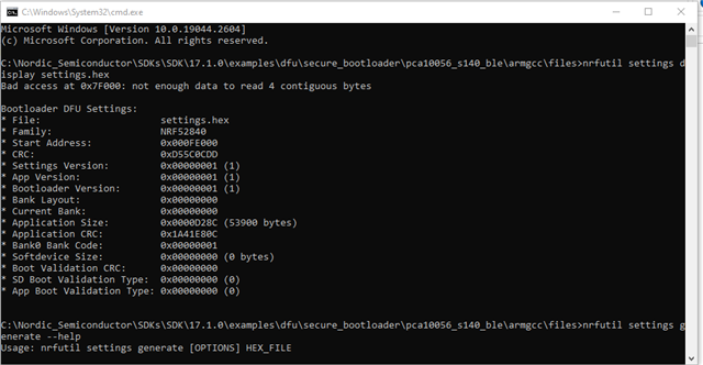

  • Those are two different CRCs. By default, the bottom one is 0x00000000:

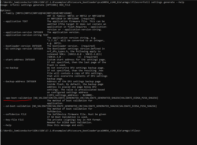

    And this is only used if you use the flag app boot validation:
    Note that this also requires some changes to the bootloader. You need to enable some settings in sdk_config.h (I don't remember which one from the top of my head).
    But remember that settings are only generated with nrfutil if you intend to flash the application with the debugger. If you intend to do a DFU, the settings will be generated by the bootloader.
    If you want to use Boot validation, you need to specify this when generating the application image using nrfutil using "nrfutil pkg generate ... --app-boot-validation <type> ..."
    Please see "nrfutil pkg generate --help".
