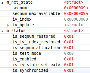

Setting a breakpoint on the mesh_stack_device_reset() line, I can inspect m_net_state and m_status from the net_state.c file and am happy to find:

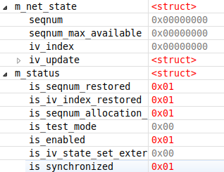

However, if I move the breakpoint to main.c immediately before entering the sd_app_evt_wait() loop, I find:
Sending a broadcast message asking all devices to clear their stored seqnum for the moving end device is an option, but if there is a way to set the seqnum so the device can come back fully synchronized that would be even more ideal and be making less of a security hole. In addition to 154, I also tried 8192 (block size) and 8193 (block size + 1) and had the same results (working on set, then resetting to 0 on reboot).
Jeremy
    Regarding the call to mesh_stack_device_reset() in your code, this call should not be needed for implementing the change. The call to net_state_iv_index_and_seqnum_block_set() should be enough to set the new values, and given enough time (writing to flash happens asynchronously and take some time) the new block should end up in flash so that the seqnum continues from that higher address after the next reset.
    The code in net_state.c responsible for allocating the block and storing it to persistent memory is in the function seqnum_block_allocate(), which gets called at the end of net_state_iv_index_and_seqnum_block_set(). I suggest using breakpoints inside seqnum_block_allocate() to check the code flow is as expected and the line with the mesh_config_entry_set() actually getting called with the new seqnum_data.
