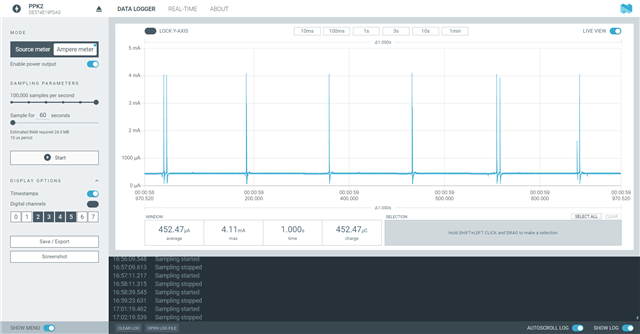

128MHz

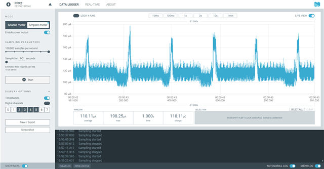

64MHz

1. First image (where you see current spikes up to 4mA, the CPU runs at 128MHz.. Second image is the case where we run with default 64MHz clock. The only difference bwteen the two cases is the following line of code.
  //make sure application CPU core is running at 128MHz
nrfx_clock_divider_set(NRF_CLOCK_DOMAIN_HFCLK, NRF_CLOCK_HFCLK_DIV_1);
and I comment it out when i like to run at default 64MHz clock..

2. I read one line somewhere that said not only will CPU consume more power while running at 128MHz, sleep current will be higher too.. is the difference in consumption shown above in line with what you think it should be  ? Baseline current difference is almost 4x
